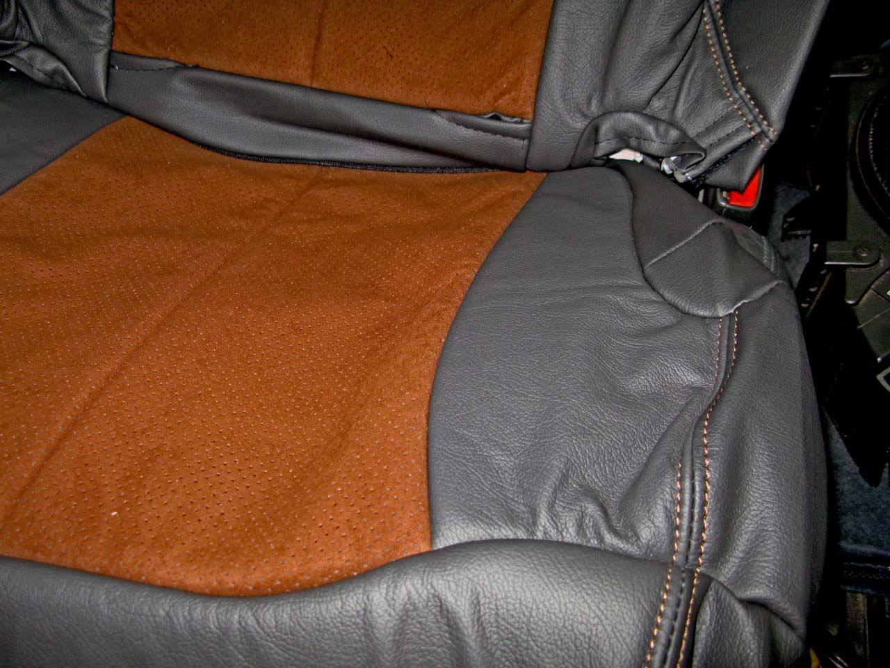

Old Oct 10, 2018 | 08:54 AM
They are top notch. They are really not "seat covers" but replacement seat upholstery. You have to fully remove the original upholstery to install them. Many GM stealerships offer custom leather interiors, they get them from Katzkin, and when done through a stealership they even get covered by the full factory vehicle warranty. I've had some before and the fit is every bit as good as the originals and the quality exceeds the originals. They have all of the exact same factory attaching points and methods. These are the ones I got for my GMC... not installed yet, just sitting loose. Factory graphite outers with perforated chocolate suede inserts with contrast chocolate stitching.
