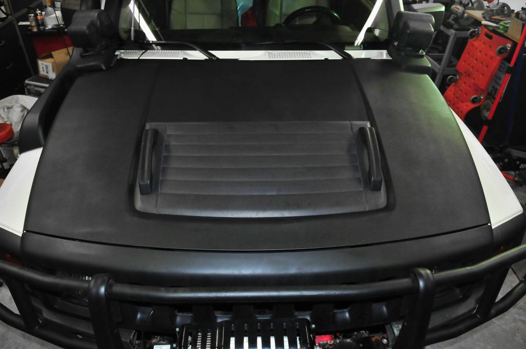

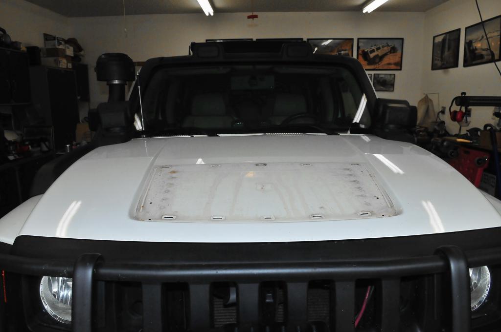

Open the hood and pinch the clips while lifting up and or pushing up on the clip and plastic stud, unless some dealer did the recall fix and glued it down!!
I removed mine to plasti-dip the hood and then replaced it. I wanted it to contrast slightly.
I also thru bolted some hood handles to keep it on.
