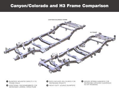

And as for the Colorado reference, I removed it from my new post, based on your recommendation. I was trying to be a bit humorous... obviously there are distinct differences. However, correct me if I am wrong, but the 5 cyl motor and the frame are almost identical to a Colorado. That is why I was saying it shouldn't be much harder to work on than a Colorado. Not that I have ever worked on one, but I know local mechanics that will work on them. I just bought this vehicle last year, and one of my main supporting arguments for buying a vehicle from a lineup that is no longer made was that a lot of parts are common to Colorado's which chould be supported by GM into the unforeseeable future. Sorry if I stepped on some H3 lover's toes . I love my H3 as well, besides this recent issue.

Frames are very different and not interchangeable. Although it is true that the original H3 concept truck was a Chevy with a Z71 off road package, less then 5% of that truck remained after the engineers broke and upgraded everything. Most of the 5% is in the 2006 3.5 engine.
The frame is just the tip of the iceburg of the differences between the H3 and Canyon/Colorado. They share a little over 5% of total parts. They actually have more in common with a 1500 due to the use of 1/2 ton rated parts.
