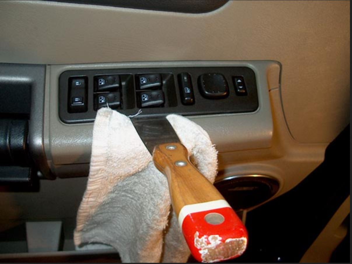

Personally I'd remove the door panel, that way you can do whatever you need to do to re-attach and reinforce it from the side that cant be seen. As mentioned the edges need to be de-greased before applying bonding agent. IPA is a good cleaner but try it out on a hidden surface 1st. Super glue is always the temptation as its quick, but its too brittle and won't last.
You could try "plastic-welding" the part back in place using a hot soldering iron (not too hot) with a clean tip (solder wiped off) carefully melting the two parts together unitl the plastic "puddles" and merges, working along the seams. Obviously you dont want to "break through" to the visible side, but with care it can be done, it doenst have to go too deep. Experiment with some scrap materials 1st, you will be amazed at how strong the joints become. Only for the brave I suspect, and of course dont blame me!
I found someone else's technique at removing the switch module (passenger side shown) using a putty knife but its not a method I've ever tried.

That's how I have always removed mine, I found that exact picture. Removing the door panel to get the switch pack out I would do at your own risk. Door panels are a lot of expensive than the plastic bezel holding the pack in. Break some of the door panel clips and you're in a much bigger world of hurt. I have taken my door panels off, all 4 and one of mine separated from the leather top portion so I used the solder iron technique to melt it back together.
