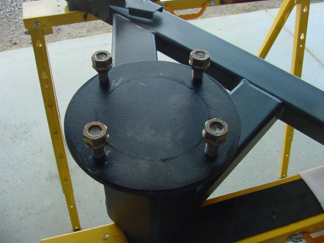

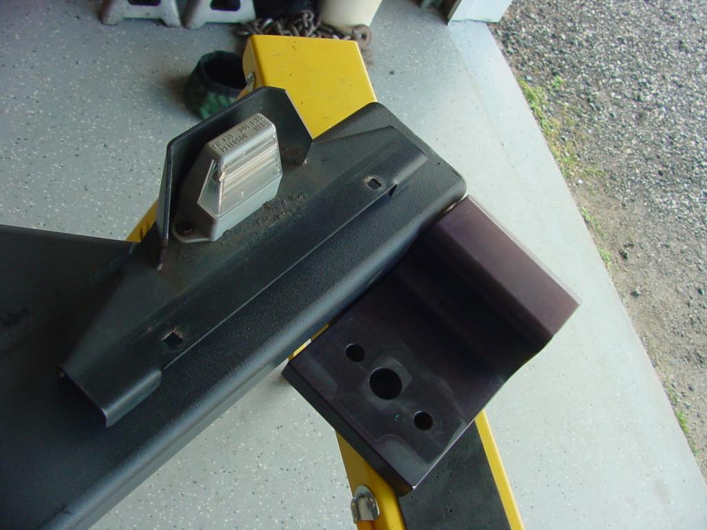

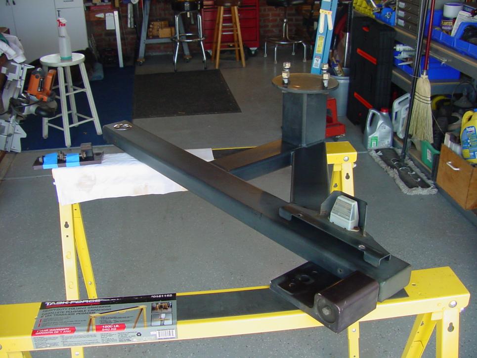

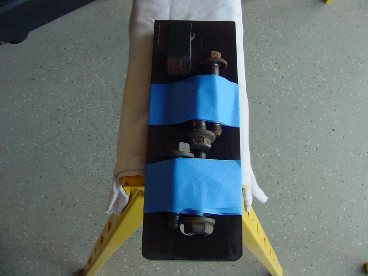

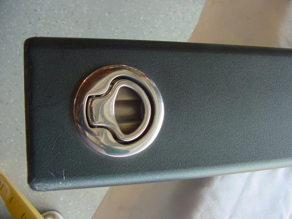

Well, I finally got around to removing my rear tire carrier and it is now available for sale. I live in Waxhaw, NC - near Charlotte. It's pretty heavy so I think that picking it up would be best. I could ship it but I think it will be expensive.
Here are some photos. I'm asking $ 300.00. I believe that's a fair price.
Take a look at the pics and let me know if anybody is interested. Thanks.
(704) 243-7269
Paul
Attached Thumbnails Rear Tire Carrier-dsc00104.jpg   Rear Tire Carrier-dsc00105.jpg   Rear Tire Carrier-dsc00106.jpg   Rear Tire Carrier-dsc00107.jpg   Rear Tire Carrier-dsc00108.jpg
