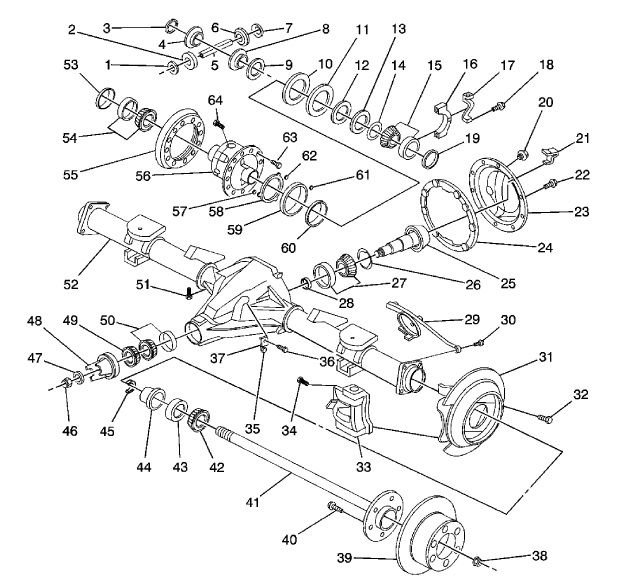

So my rear locker in my h3 has finally stopped working. I press the button and the light comes on and my left rear wheel will not rotate at the same speed as the other tire. There is also a loud popping noise coming from the area as if it is slipping. Before I open up the diff and take a look, I was just wondering if anyone else has had problems with them and if I should just buy another locker or get a service kit and repair this one.

Sorry I meant to say that I did look and the pins were chewed up and was wondering if The service kit they sell for them come with the pins.
Look at the pictures before you purchase!

SO you have the diff disassembled? If so you can see what parts need to be replaced.
Check to see if the service kit has the parts you need to replace.
If not, you will need a new Eaton Elocker.
Eaton Model: 19659-010 GM 8.5" / 8.6" 30 SplineThis Eaton E-Locker fits GM 8.6" axles with 30 spline axle shafts.
