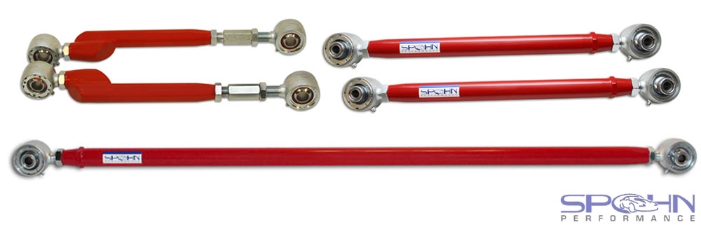

i've just ordered the complete "Off-Road" Rear Suspension Package - Del-Sphere Pivot Joints been on my list for the past two years and just 3 hours before seeing this post i pulled the trigger
Attached Thumbnails Rear control / trailing arms?-rear-suspension-package-hummer-h2-1.jpg

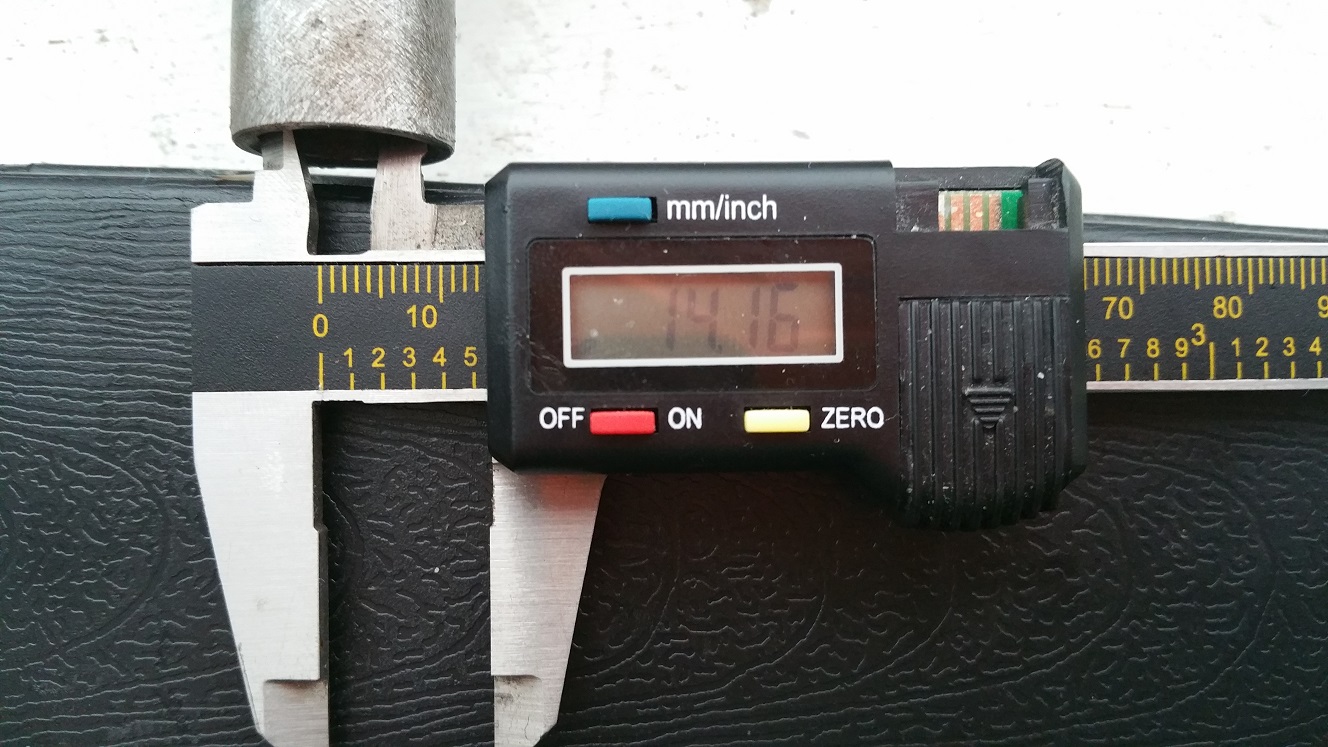

As for the business end of this, here's some pics.
The sleeve is a hair too small.
ID is 14.16mm.

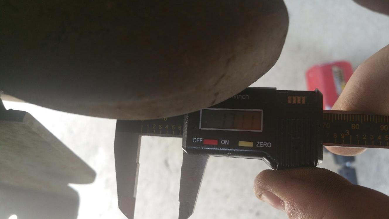

Bolt diameter is 14.57mm, so now way it'll fit.
