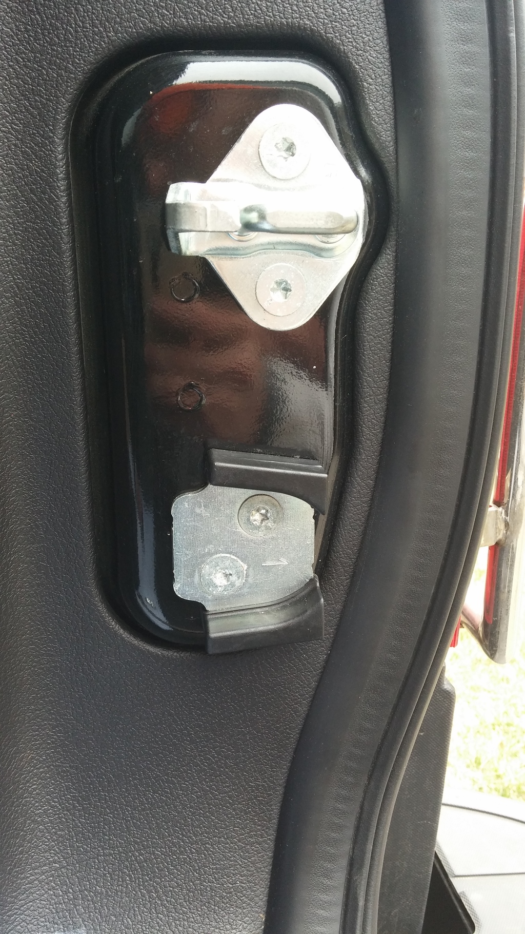

I had a clunking noise coming from the passenger side rear, couldn't really tell if it was under the truck or not. After about a week of listening to it and many forum searches. I found It was the rear door bottom latch support mechanism. The part below the latch that sits on the door jam that needed to be adjusted. A temporary fix was to wrap 5 or 6 loops of electrical tape around this metal 'V" plate (on the truck side) to snug it up where it mates into the "female" side on the door. May not be your issue, but worth a try.

Is this what your talking about ?
