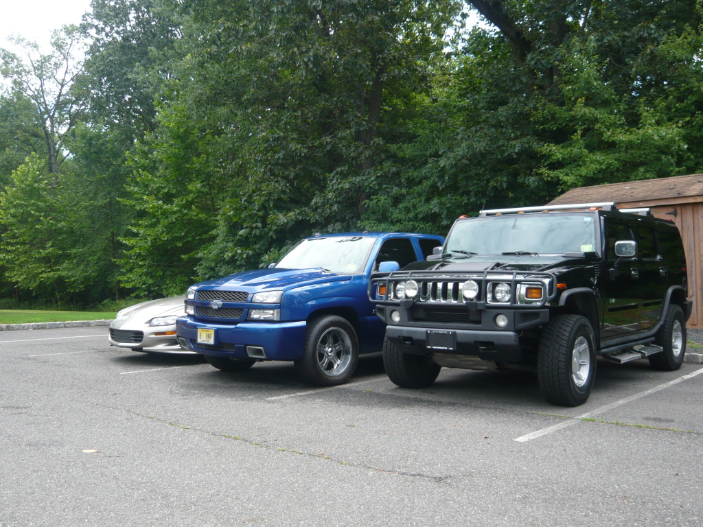

here is a pic of my rig

Nice rig! I'm also partial to the Pewter Camaro I see there..;D
Had and 01 NBM myself..
