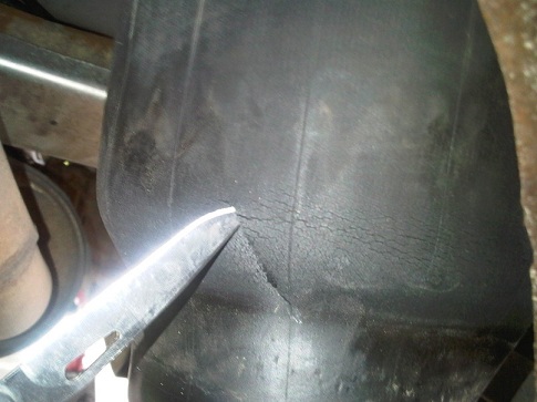

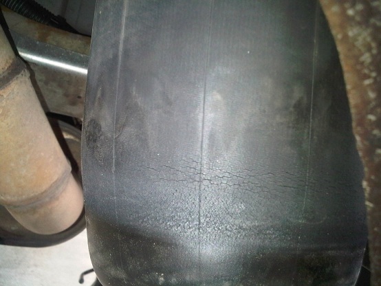

thnx for the comment on the bags... I feel better that I decided to get them... and you guys are right I need them any way... after your comment I bet mine are pretty bad... I can see a good amount of dry rot cracks at the bottom fold... just never saw a leak is all. We will see.
EDIT:

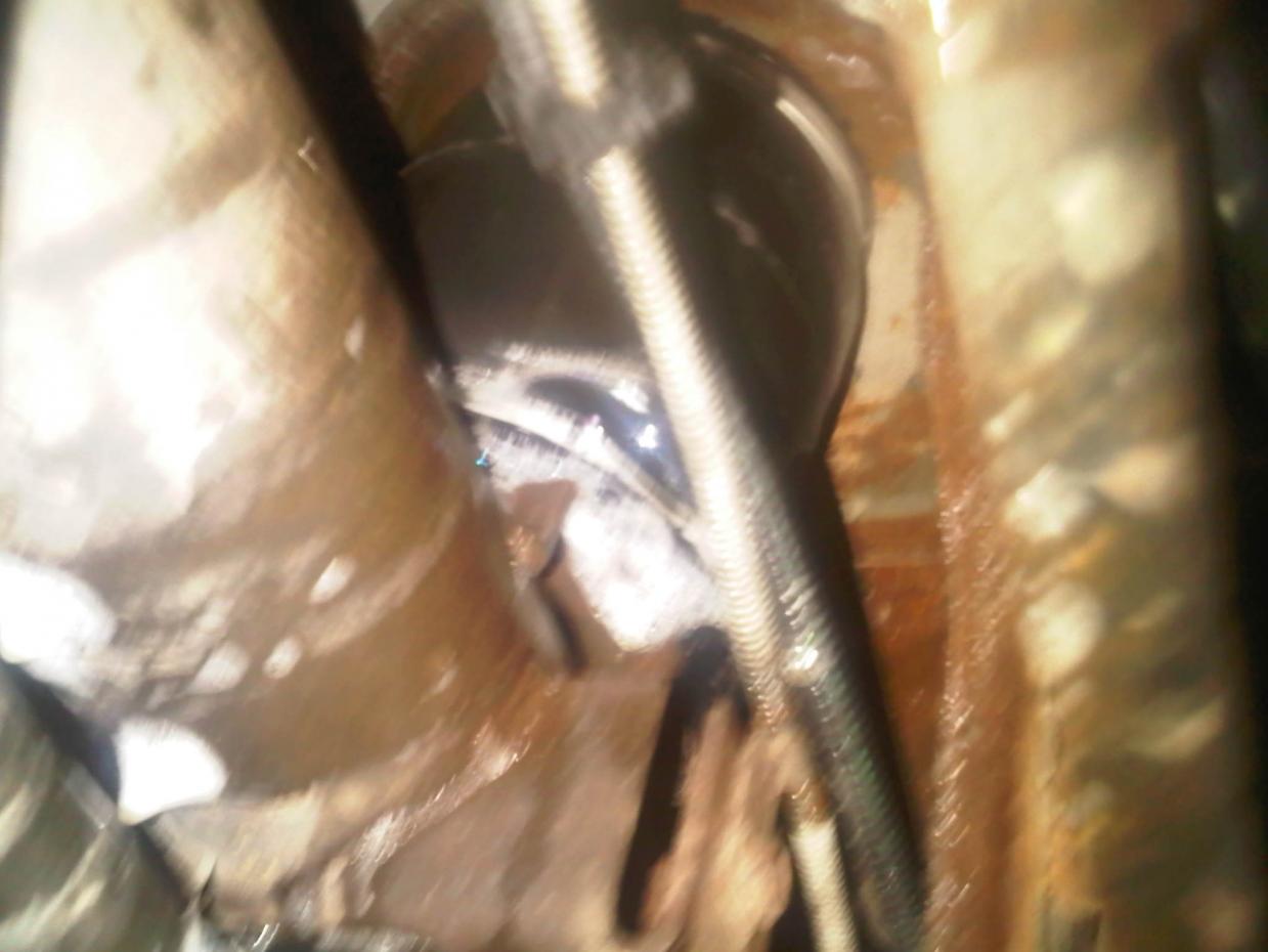

Well I am feeling pretty good about just ordering the bags, and good call guys... I parked my Hummer on the street and had passenger side on the curb well that triggered the leak, once I noticed it I ran out and grabbed my bottle of soapy water and sprayed down the passenger side air spring and found this I watched it grow from nothing... till it popped... if it wasnt leaking air... it wouldnt have filled up and popped. Thanks guys for your help.

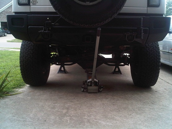

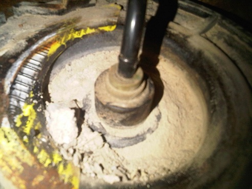

OK, So I got the bags today, and they are in fact the same ones on it "Factory"... I jacked up the tuck from the rear end as high as my 3 ton would go (not as high as I would have liked). Then I put jack stands under each side of the frame for support and chock/blocks in front of each tire. I then let the jack down all the way (well till the tires were back on the ground)... then I took my knife to the bags... note the passenger had little air in it (or at least compared to the other it had way less pressure). After which to give me more room I cut the bags in half to give me more access... Now the hard part is really (or at least so far) getting the lines off... Only way I could do this was to push the retaining clip in and turn counter clockwise to take the top of the bag out of the frame... then I used both of my index fingers to hold down the metal ring on the bag where the hose connects to it and it tried to hold the line as well and pull, at one point I could not hold the line and gave a tug anyway and it popped out... If you had a buddy here to hold the line as you pulled the bag it would make short work of this. Once I got them both out I said to myself it’s a great time to clean the frame up and use my Eastwood frame restore kit I had sitting on a shelf So I will continue on tomorrow with shots of the frame clean up... I hope this will benefit someone in the future... But just know it is an easy job over all (So Far).
