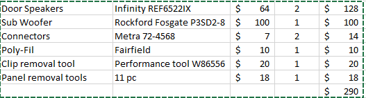

a0128 Nov 4, 2017 10:34 AM
Replace your subwoofer while you are at it. Here is what you need:
https://cimg7.ibsrv.net/gimg/www.hum...a234949e08.png
Most of the stuff is available from Amazon.
