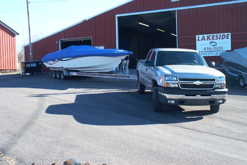

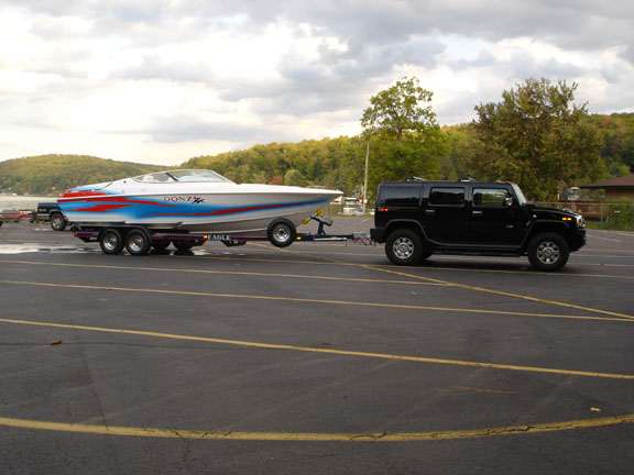

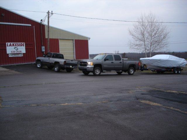

I think the reason that people are or get dissapointed is that they are expecting a H2 to pull a load just a peppy as a duramax equipped truck.. If you take away the acceleration under a heavy towing load & look at the other things besides acceleration, they aren't really bad at all.. All things considered..
Also yes the 07 should have the 6.2 instead of the 6.0..
I have had HD trucks both gas & oil burners and towed some pretty big stuff.. So I can speak from both sides of the fence..
Jamie
