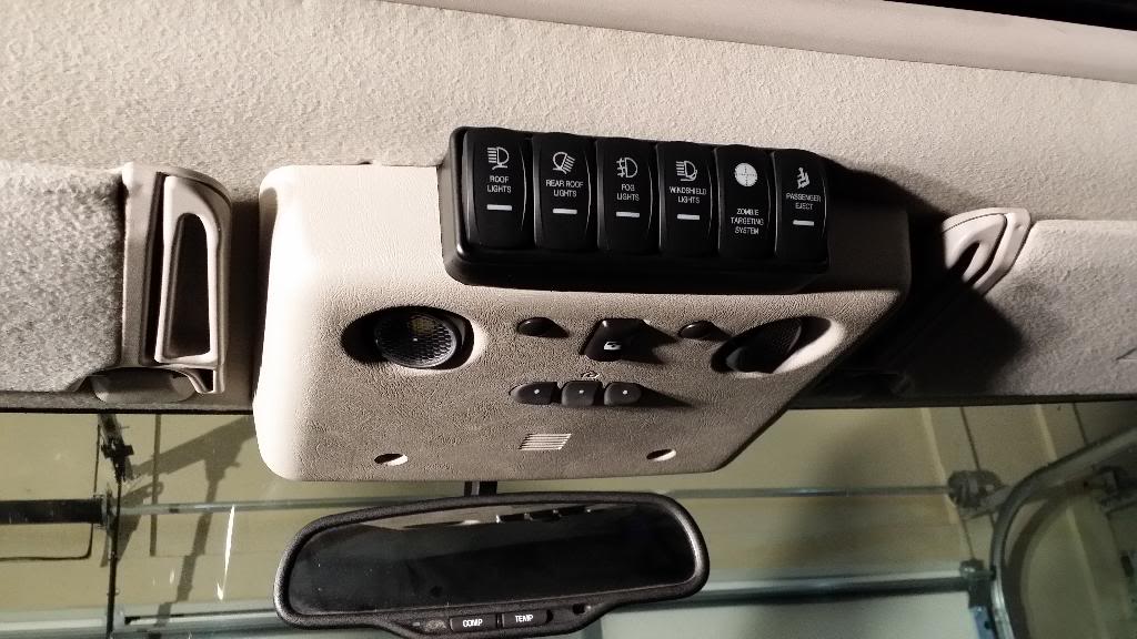

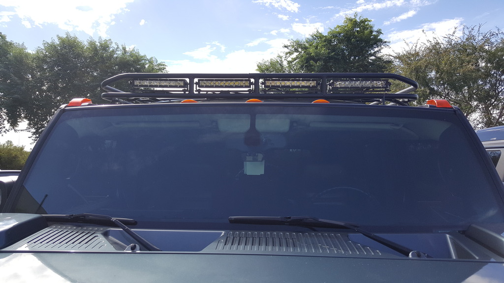

Old Apr 28, 2016 | 01:47 AM
LoJac963's Avatar
Joined: Jul 2011
Posts: 2,357
From: Surprise, AZ
All of my wires run down the outer window trim on the driver side into the engine compartment. The wires then connect to relays in the engine compartment which are triggered from switches inside.
