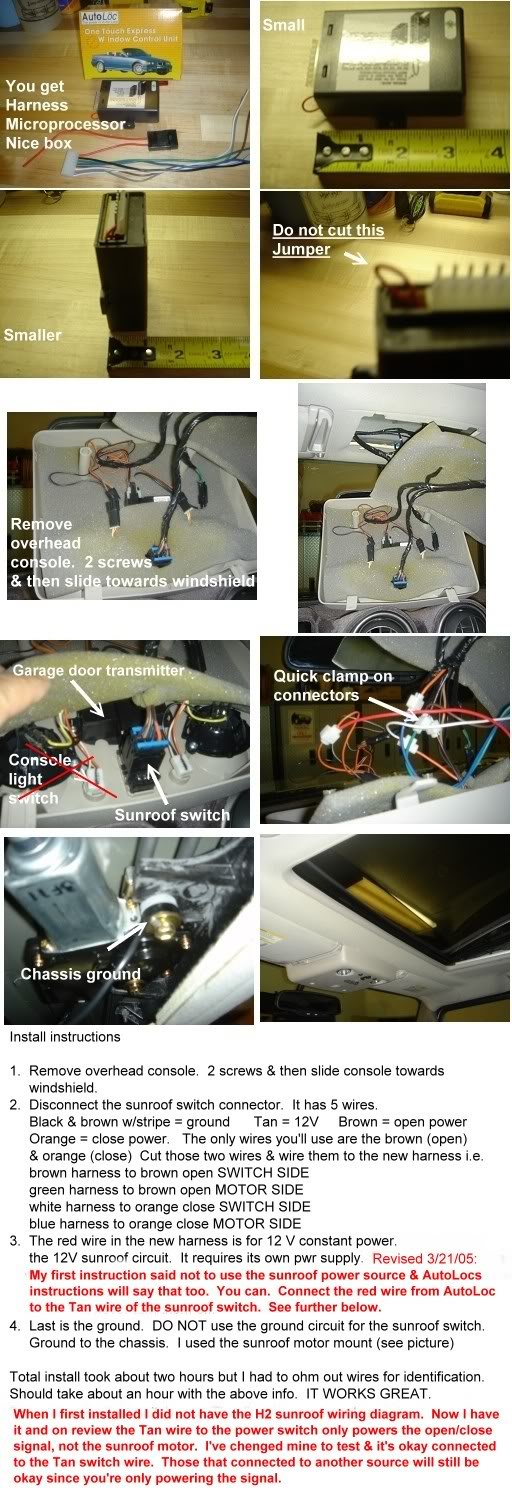

I bought this thing called AUTOLOC a couple of months BEFORE my sunroof went last year, but haven't installed it yet. I wanted to wait till my sunroof was 100% cause I didn't want to chance voiding any warranty!!
Here's the info from the "OTHER" Forum!
"One touch & it opens all the way. One touch & it closes. One more touch & it tilts open. Just touch anywhere while it's traveling & it stops there. Great upgrade for only $40 bucks plus shipping. Here's pics & some hints to shorten install time. Oh I need to add to the install instructions the processor is small enough to just lay inside the overhead console. Enough foam it won't rattle. My H2 is an '03. Confirm the wiring in your H2 is the same before making connections"
