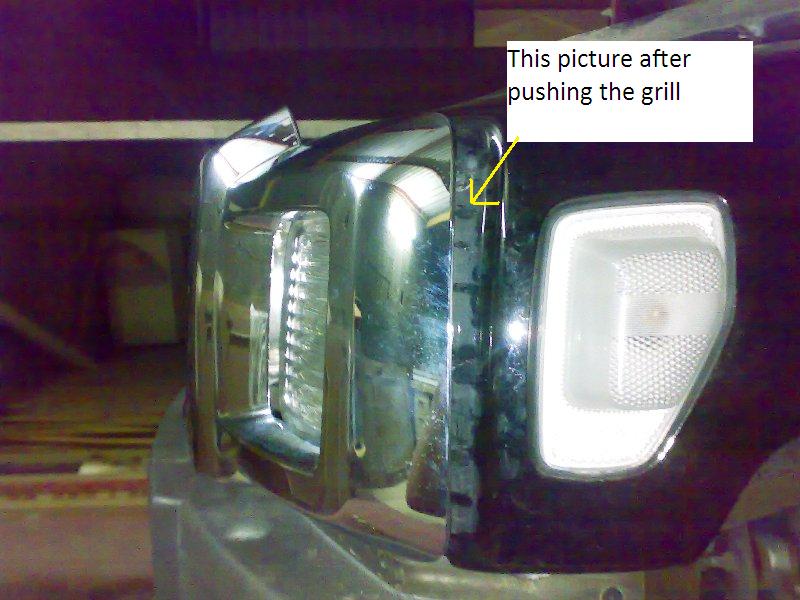

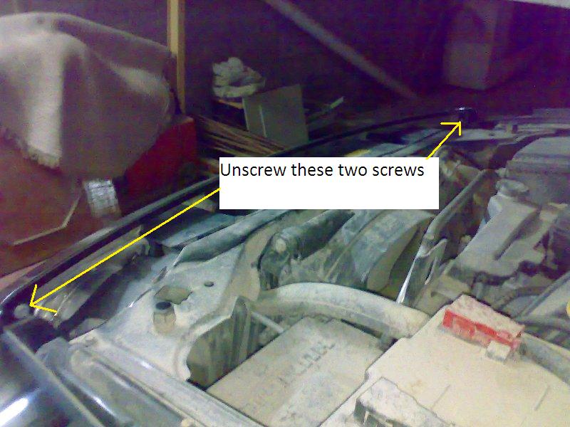

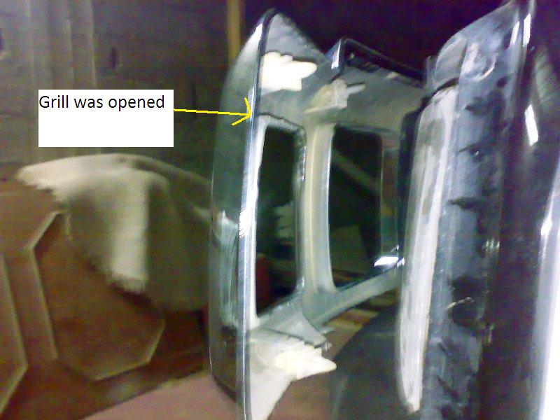

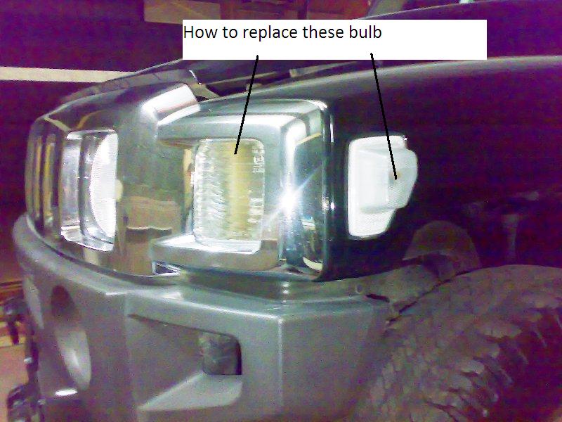

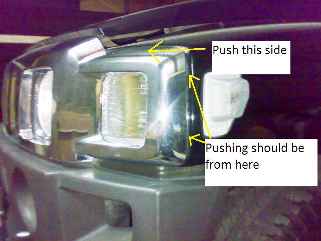

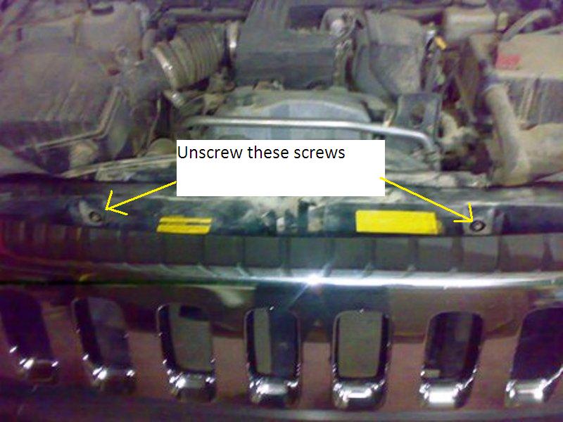

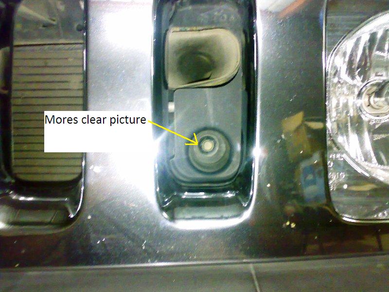

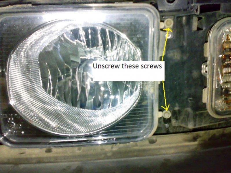

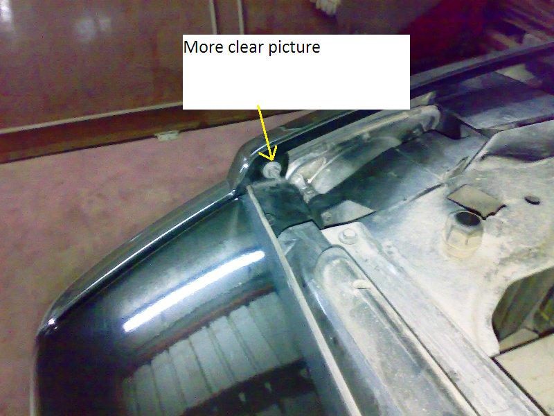

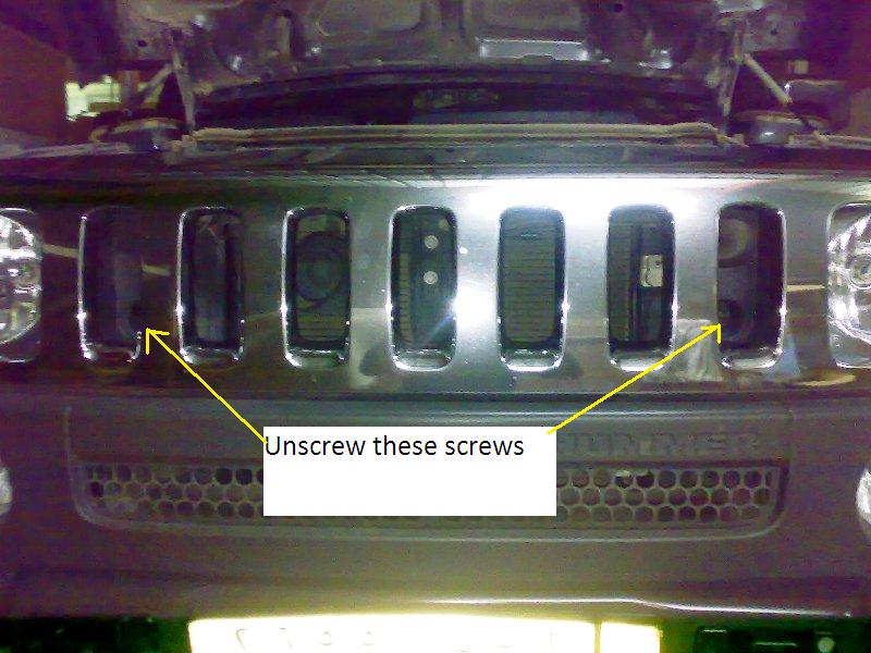

Here I will show you how to replace the bulb, since the dealier replace them around 75 dollar !!!! I traied to replace them my self.
Tools:
1- 10mm nut driver.
2- New bulb.
3- Your hand.
1-
2-
3-
4-
5-
6-
7-
8-
9-
10-
11- The picture down ( screw is locating under the headlight).
12-
I attached the picture if they are not appear.

Thanks for the pics. I just purchased a black grille for my H3 and will also be swapping out the turn signal for a clear version. Your pictures will help considerably. BTW this is the first time I've seen side markers like that on the vehicle.
