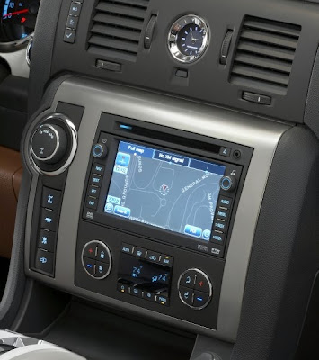

I wanted to know did anyone on this forum hv any problem's with their factory install. I have a 03 h2 and bought a 06 navi, touchscreen from a forum member jeep60s. And its seems i can't get any sound and the navi is not working properly. Any suggestions will be help. Thanks

You need to have the unit unlocked by the dealer and then you need to run a wire from the cluster to the Nav connector for the speed input.

I'm new to this forum, but I do have 06 HUMMER H2. I've managed to get
a factory navigation system like this.
Unfortunately it seems that the plugs in my
car do not match with the plugs of the navi system. Is there a "kit" or any solution to
get this thing to work in my hummie, or I just bought something I won't be able to use?
Any help or solution will be appreciated. Looking forward for your replies. Thank you.

No connections that I know of - they totally redid the interior in 08, and that's where that nav is from, which is why it isn't even close to fitting in the 06....

Thank you for the fast reply. So, according to your knowledge, no workaround possible to connect the device electrically to the car's system?

Hi all! I took some pictures of my navi system. It has some stickers with production date of 2006,
and as it seems, it totally misled me suggesting it will be ok in my hummer from same year.
Unfortunately there is no correlation between production year and compatibility,
I found it out in a hard way.
