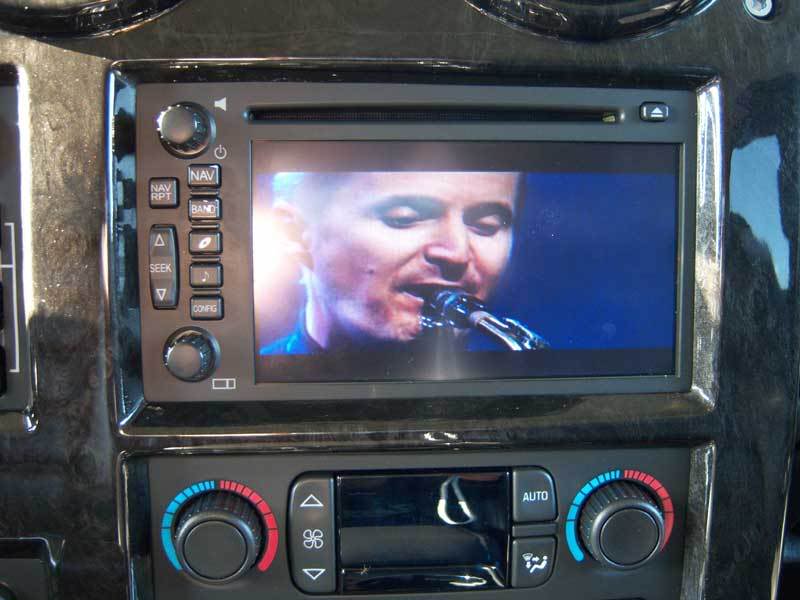

ORIGINAL: 1ST.H2.SUT
HAS ANYONE PUT A DVD PLAYER IN CONSOLE TO PLAY DVDS ON FACTORY NAV RADIO HEAD UNIT WITH THIS VIDEO NAV INTERFACE ADAPTER (PAC VCI-GM2 GM NAVIGATION VIDEO SCREEN INTERFACE) AND WILL IT PLAY IN DRIVE??? FIRST TIME POST! PLEASE HELP!!!
I have a similar interfaceinstalledon my H2 factory Nav.[/align]These units will NOT allow you to use your factory Nav DRIVE to play DVD's, you need to have a separate DVD drive and tap the signal into the unit.[/align][/align]The interface turns your Nav screen into a MONITOR, so you still need to provide a signal. [/align][/align]On my setup, I'm using a Visualogic DVD headrestand its signal is fed into the interface unit. [/align][/align]And yes, you can play DVD's through the Nav while in full motion.[/align][/align][/align]
