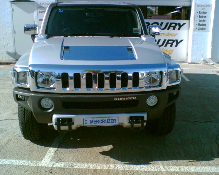

Hi from Down Under in Oz
I have a question that hopefully you fellow Hummer owners could help me with
I am looking at installing this unit http://www.pioneer.com.au/Products/N...VIC-F20BT.aspx in my 2008 H3 which has a monsoon sound system in it.
I imagine it is the same as the american version http://www.pioneerelectronics.com/PU...ms/AVIC-Z120BT
The warning chimes run through the standard stereo system? and if so how can you get them to work on the new pioneer one....is it even possible?
Thx in advance for any help as it can be hard getting a straight answer from a car stereo salesman
Attached Thumbnails Pioneer Navigation-hummer.jpg   Pioneer Navigation-hummer-01.jpg
