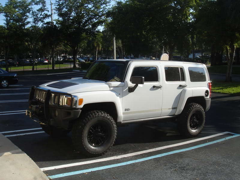

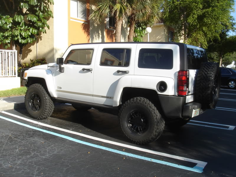

Painted My Wheels
Old Nov 6, 2007 | 02:46 PM
GarrettMoore's Avatar
Joined: Apr 2007
Posts: 169
Default Painted My Wheels

looks good...is that parking lot slanted or do you have a fat chick stuffed in the back of your h3?

GM, I like it, nice job on the painted wheels! [sm=smiley20.gif]
I'll send you some pics of snow to go with your palm trees this winter. [8D][8D][8D]

what paint did you use?

I used Dupli-Color engine enamel.
I just removed all 5 wheels, washed them, sanded them lightly, washed them again, and gave them about six coats each.
If anyone else tries this, I would recommend doing about two really light coats to get a good base on the wheels. Then you can start really laying it down without fears of poor adhesion or runs. The heavier final coats will provide a smooth look even on the rough portions of spokes.
