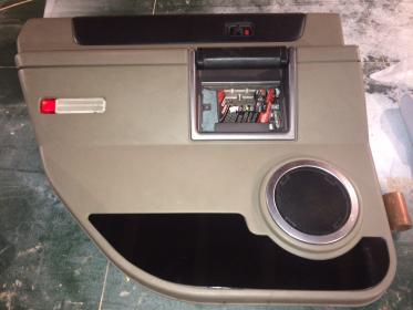

Well I like the results. I also show some steps I took and what the original door looked like. I ended up redoing this one because it was a little short on the bottom

Thanks...basically I pulled everything out of the truck and cleaned it up. The radio bezel and console lid I did in black plasti dip and everything else is gloss black duplicolor plastic spraypaint. I'll add better pics when I finish the door pieces. My flash on the camera at night made the pics look a little wierd, I noticed in the pics the a/c vents and stuff really stand out against the black but it actually looks bad *** and blends in nicely.

I disassembled everything and cleaned it with thinner before I painted.

If you have chips or scratches I would use some sandable primer/filler first then sand it down to fill them in and then paint. I just used a rag with VERY little thinner to clean off the dust and dirt before painting. A lot of it might actually melt the plastic. Also make sure the areas to paint haven't recently been cleaned with something like armor-all as that will probably mess it up the paint adhesion.
