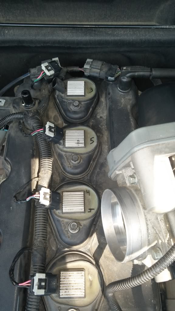

The marked numbers are how they sat in line before i moved them(orginal stock positions). The reason its 3, 5, then 4 is because initially when i received the first p0305 i switched 4 and 5. Then i got the p0305 again, so i switched 3 with 5, giving me this result.

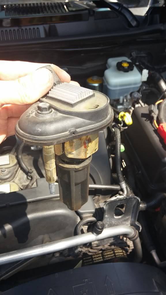

Switched coil pack 5 with three, and also inspected and reinstalled the 5th spark plug. Appeared fine. Also checked the wiring to plug 5, seemed fine.
Notice how dirty coil pack 3 is.

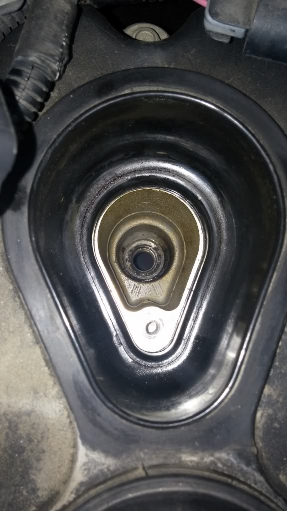

Where coil pack 5 sits, looks clean.

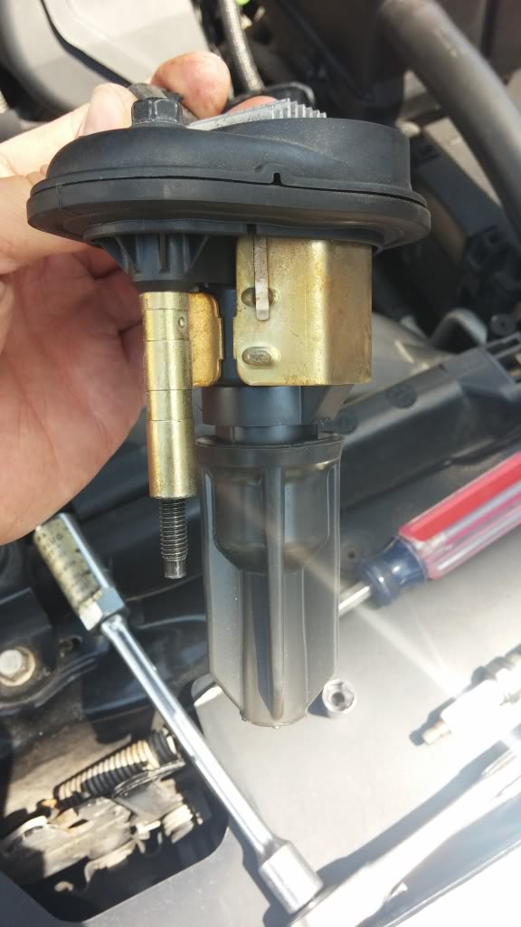

Coil pack 5, much cleaner than 3. Odd!

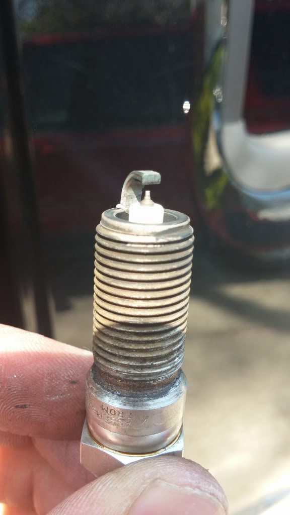

Spark plug 5. No damage, seems clean.
