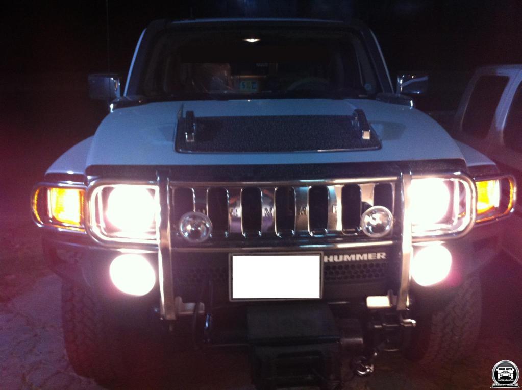

here my rig with no OBD codes and no CEL any more
