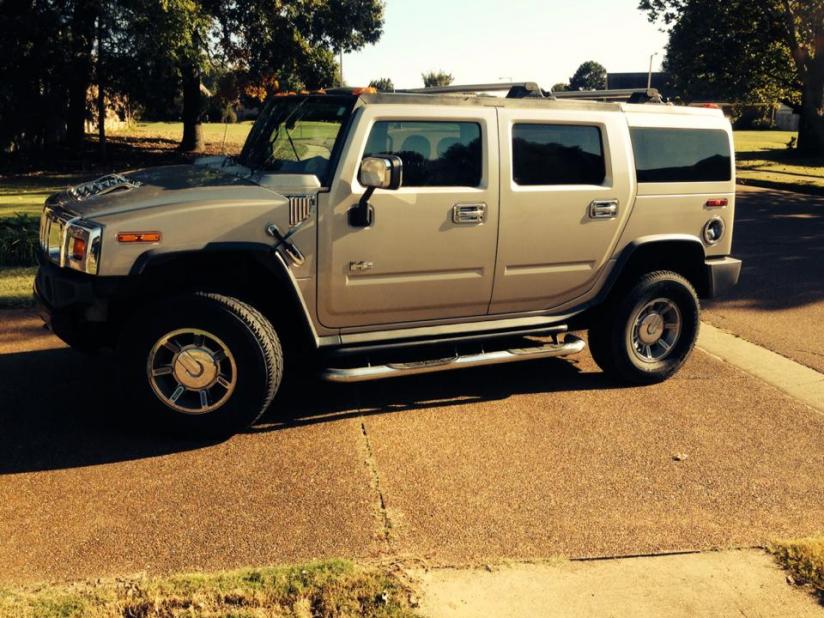

I am going crazy driving my girlfriends honda accord haha. I miss the beast. Also if that is your hummer in your profile pic mine looks very similar. Here's two pics of mine
