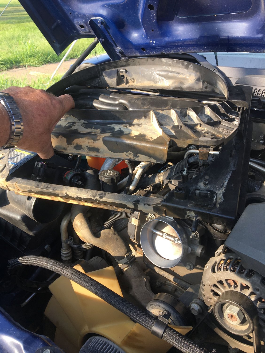

Originally Posted by Cohiba54
Ok I'm going to need some help from yall. I see on youtube how to remove the radiator which shows the fan shroud having a way to rotate the lower portion then lifting up and out. Alpha fan shrouds must be different thou because I do not have the release leaver or slide handle on the left side as shown in the vid. The vid also shows dust covers and circle type spring clips for the trans line disconnects. Mine do not have the dust covers nor do i see a slot for the clip.
So how do you remove the fan shroud and the trans lines off?
There is a lower portion of the shroud that needs to be removed first.

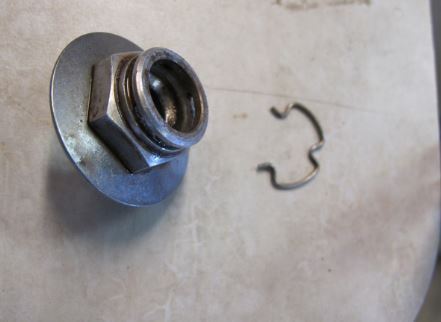

There are 2 black plastic retainers for the c clips. pull the black plastic retainers toward the engine.
There will be 2 small E-clips ( 1 on each side) holding the lines in. I use a 90 degree pick tool to remove them.
DON'T let them fly off unless your replacement radiator has them installed already!!!

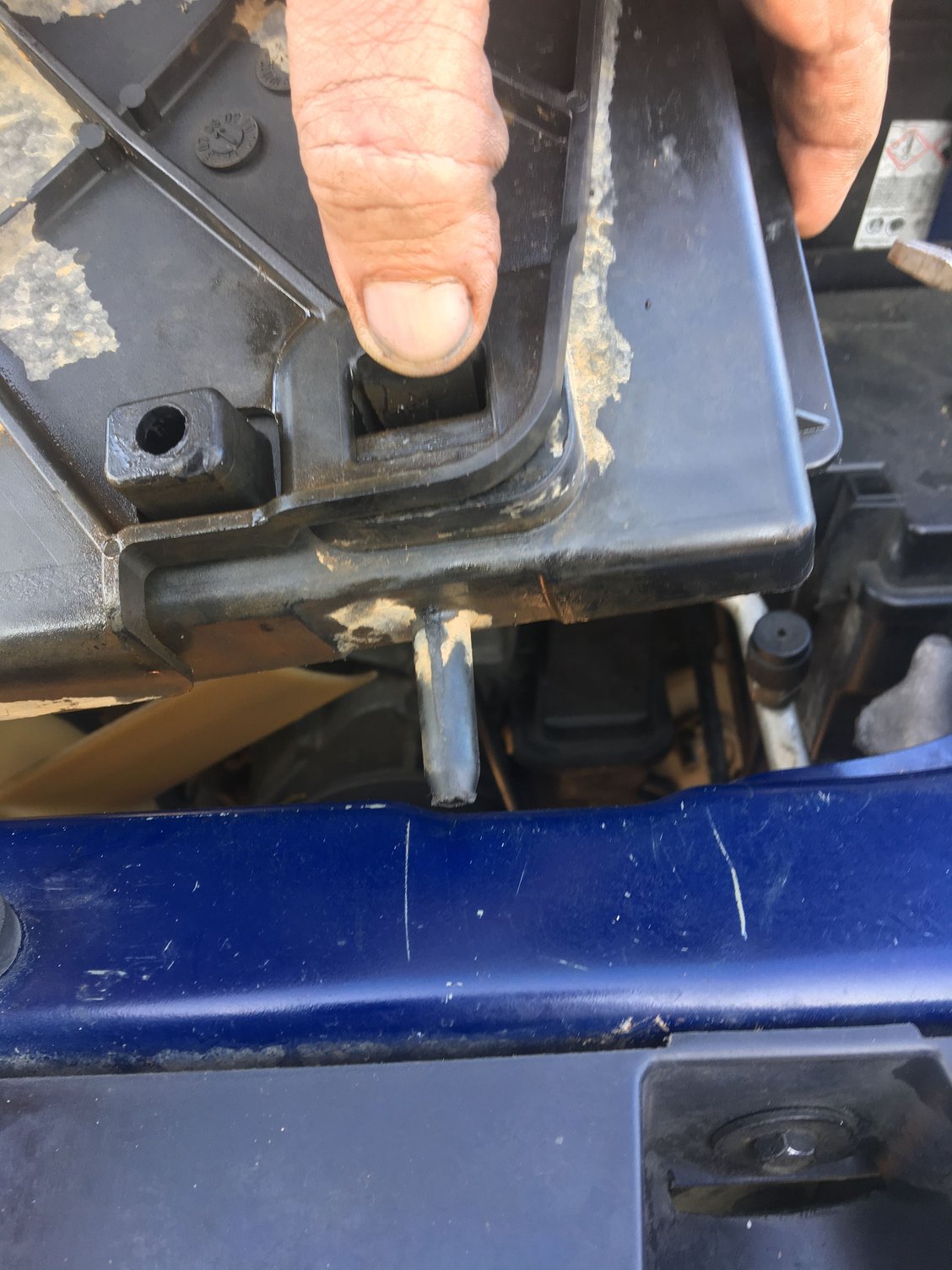

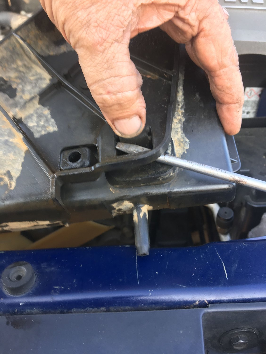

To remove the Alpha fan shroud locate the two tabs one each at the bottom (lower portion) of the shroud. Best to use a small 90 degree pry to push up and a screwdriver in the seam to pry apart then pull it down and slide it out.
