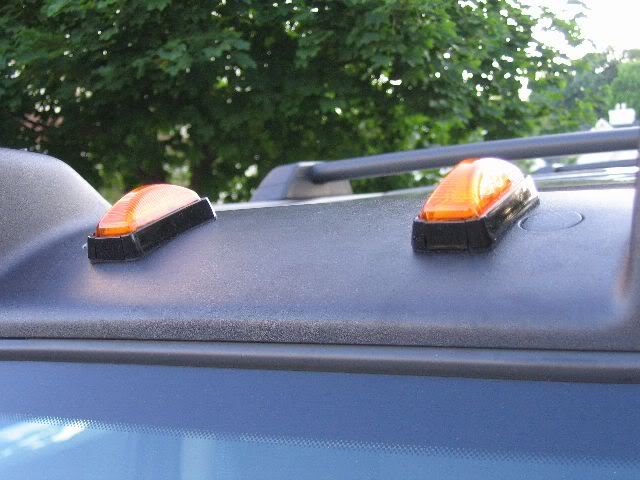

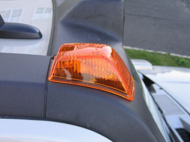

Once the lights were sorted out, I took the front corner pieces off (two screws behind the plastic seal by the front doors, and couple of clips that you could just pull to release). Drilled the necessary holes for the plastic pieces, including a central hole to run the LED wires through. Repeated for other side. This sorted out the mechanical installation of the front corner marker lights.
For the installation of the middle two marker lights, instead of buying the OEM marker pieces at $40 a pop which are also pretty large occupying much of the center space, I went with the eastmarine pieces again, only this time amber in color.
http://shop.easternmarine.com/index....categoryID=285
Took off the off-road light bar off(couple of screws on the top, had to cut the wire powering the lights so I could take it down), drilled the necessary holes for the LEDs andmounted them. Reconnected the off-road lights wires with quick connects, wired up the LEDs (2 wires per LED) and put the off-road light bar back. Then wired up the corner plastic pieces (again 2 wires per LED).
Regarding the power source for the lights, I contemplated pulling them from the front hood (somewhere from the side marker lights) but they seemed too difficult to get to/wasn't obvious, so I decided to just pull them from the back marker lights as well... there's a condiut running below the roof rails front to back, so I just tapped into the back corner lights and pulled two wires to the front (for both sides). Connected them to the front lights (so all marker lights installed in parallel), reinstalled the front corner frame pieces, reinstalled the front door seal and I think that was pretty much it...
So far the lights have been holding good, I must have used up like 3 rolls of black electrical tape to make sure everything that could be water-damaged waterproof...
Hope that helps! Let me know if you need more details!

Bonzaiii, check these out.. check out the position of the lightbar vs the front windscreen, check out the position of the lightbar vs the front corner piece and check out the lightbar vs the onstar antenna... see if that helps... my lightbar was factory installed so hopefully they did a pretty decent job at getting the right position. From what I see, it seems to be positioned ok.
