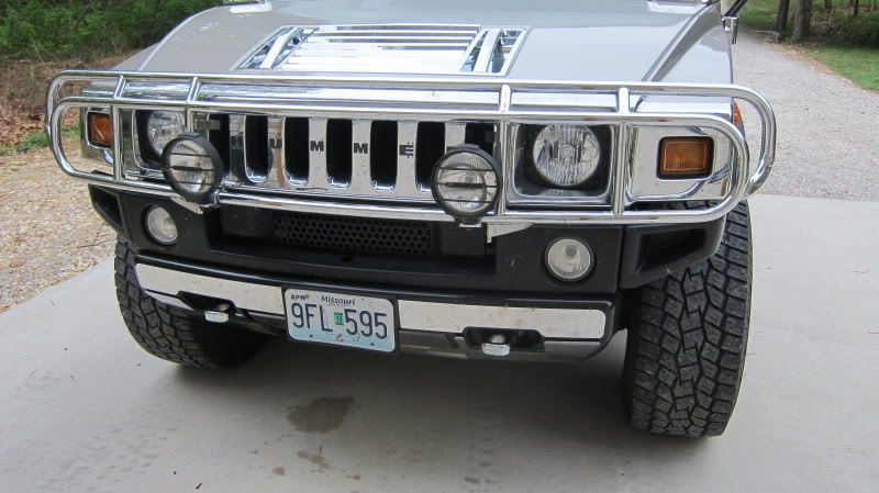

I have these lights on the truck and they were plugged in the slot the brake controller goes into also

**nlhummer, I have the same set up as you do, it doesn't make sense why they would make the plug indexed so it goes into the brake controller. I am going to disconnect all the fog light controlls and then go old school and just wire a relay off an accessory power circuit.
**H2CANEPADESIGN, correct the daytime runners are part of the original wiring and yes the fog lights OEM for the brushguard run into the fuse box, but it seems the indexing on the plug fits only the electronic brake controller. It seems a little odd, why not just use one of the other modules on the fuse block.
