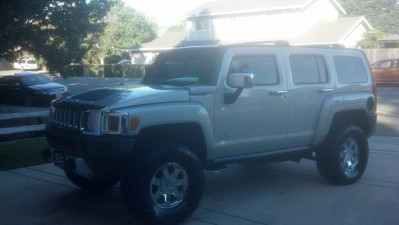

Here's mine with just the torsion bar adjustment on 35" Goodyear Duratrac's.

Here is mine, stock with the torsion lift and a new set of 305 Dura tracs. Makes all the difference in the world, now people stop and look as you drive by!
