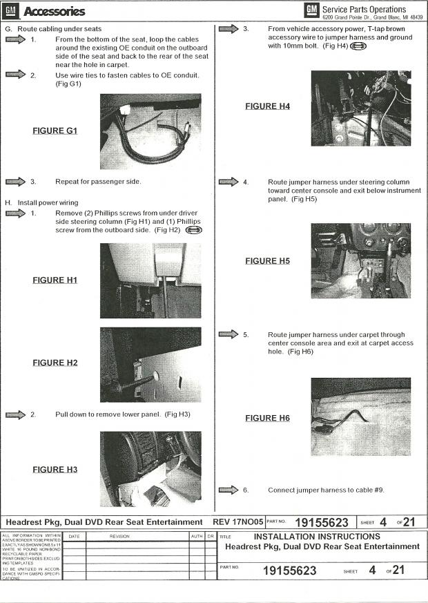

Default Wire above the parking brake pedal
Look above the parking brake pedal, if I remember correctly there is a [brown with red tracer] that is switched with the ignition. I installed the OEM system and this is the wire requested by GM. Easy to check with volt meter. If I find my install sheet I will confirm this. Good luck, a great way to provide a little peace in the back while on long drives.

Default photo of wire loom
Here is the BROWN wire I used for the power supply. I also scanned the install manual, but it defaulted to Microsoft Word. Can you open the documents if I send a message with that folder?

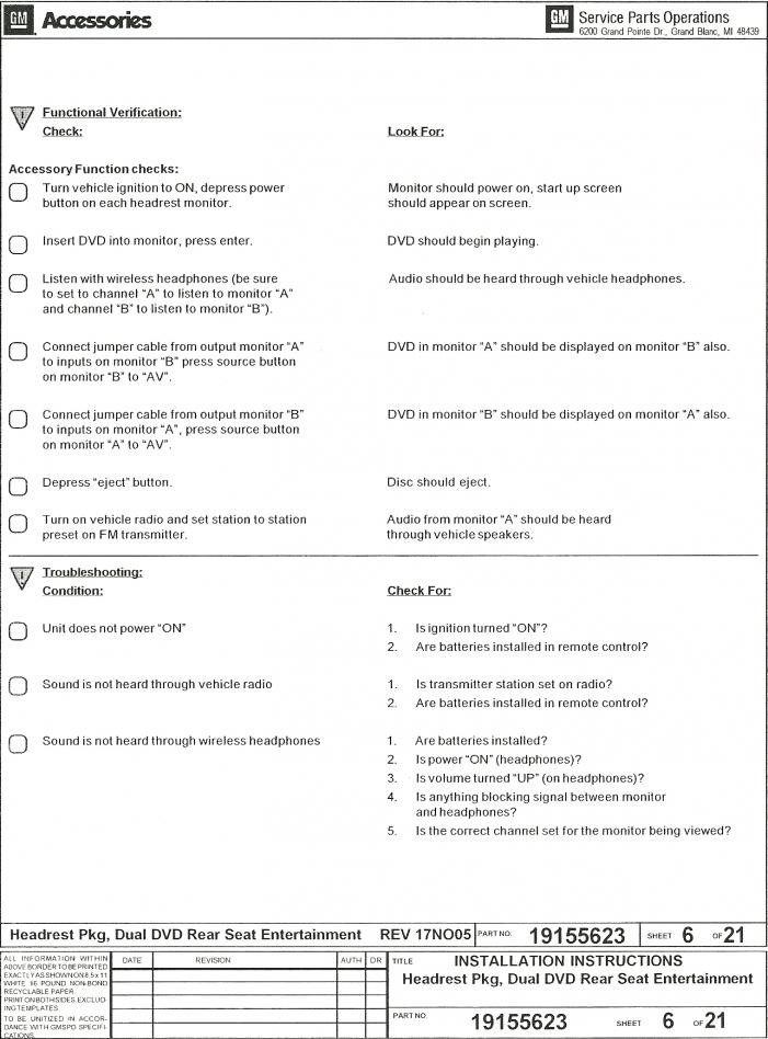

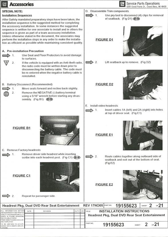

Thumbs up Installation manual
Enclosed is the OEM manual first 5 pages.
Attached Thumbnails Newbie!!! rear dvd install-scan0003.jpg   Newbie!!! rear dvd install-scan0004.jpg   Newbie!!! rear dvd install-scan0005.jpg   Newbie!!! rear dvd install-scan0006.jpg   Newbie!!! rear dvd install-scan0007.jpg
Old Nov 22, 2010 | 07:49 PM
mcampjr's Avatar
Posts: 20
From: WI
Thumbs up DVD Manual part 2
Last two pages.
Attached Thumbnails Newbie!!! rear dvd install-scan0008.jpg   Newbie!!! rear dvd install-scan0009.jpg
