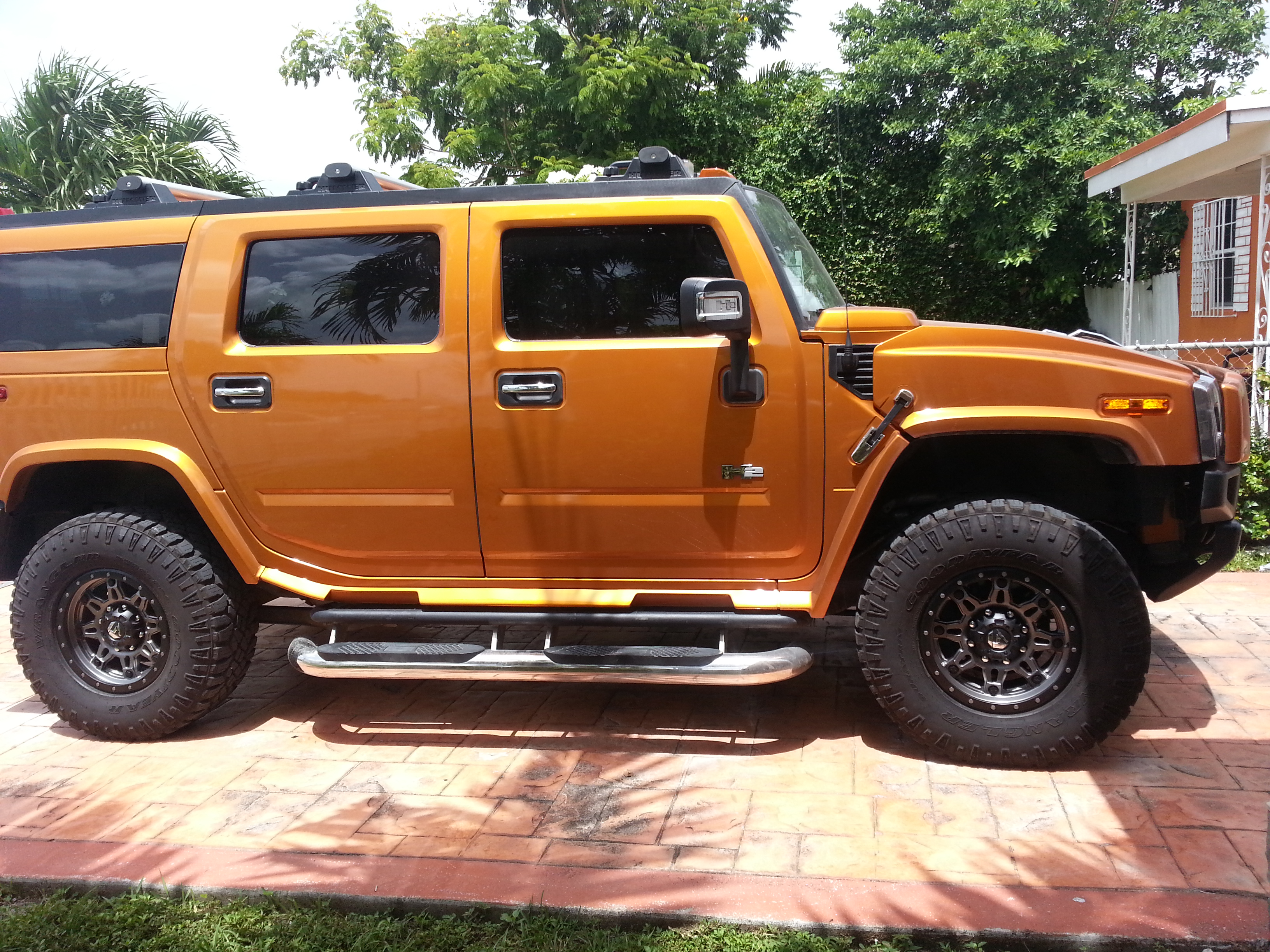

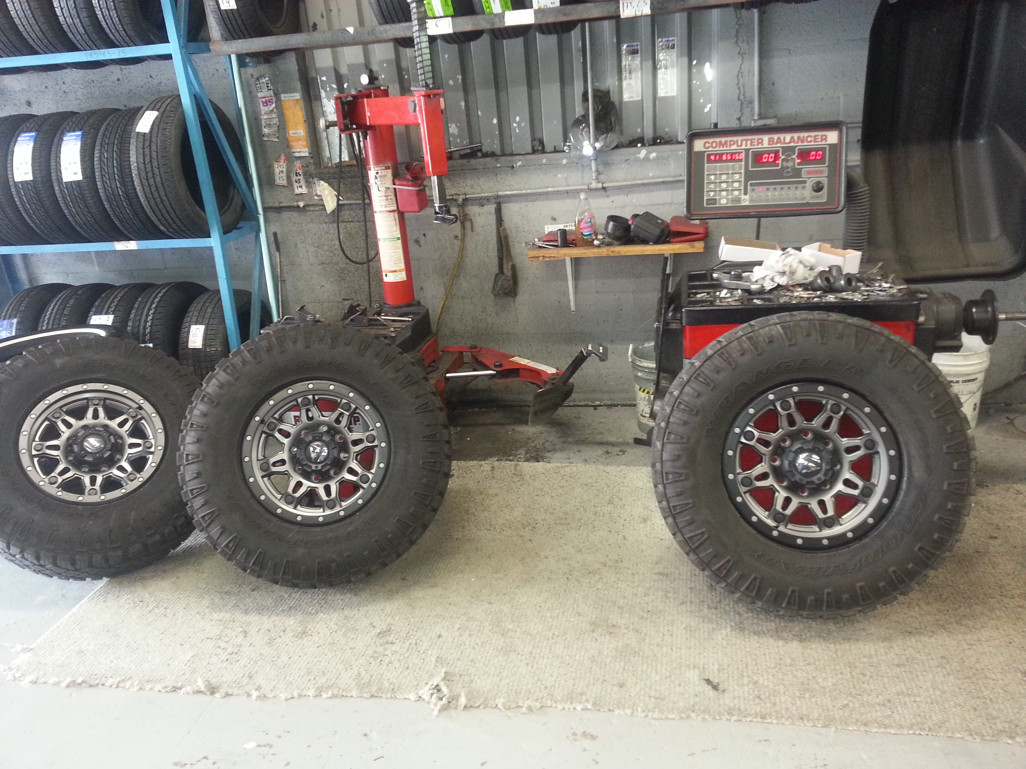

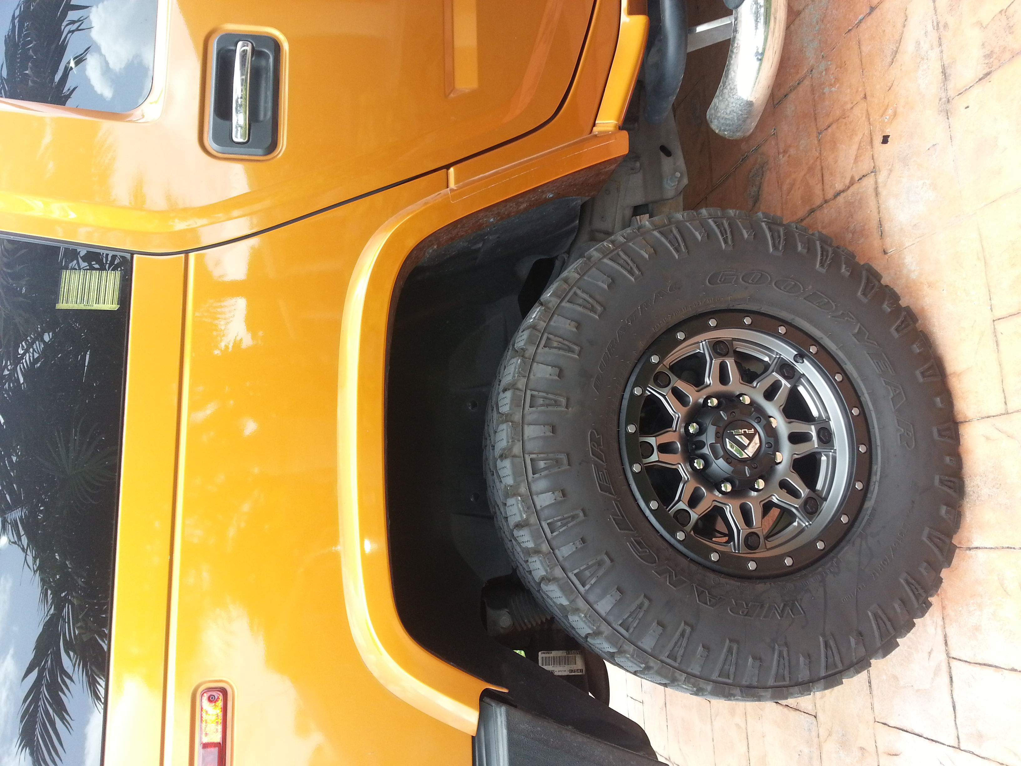

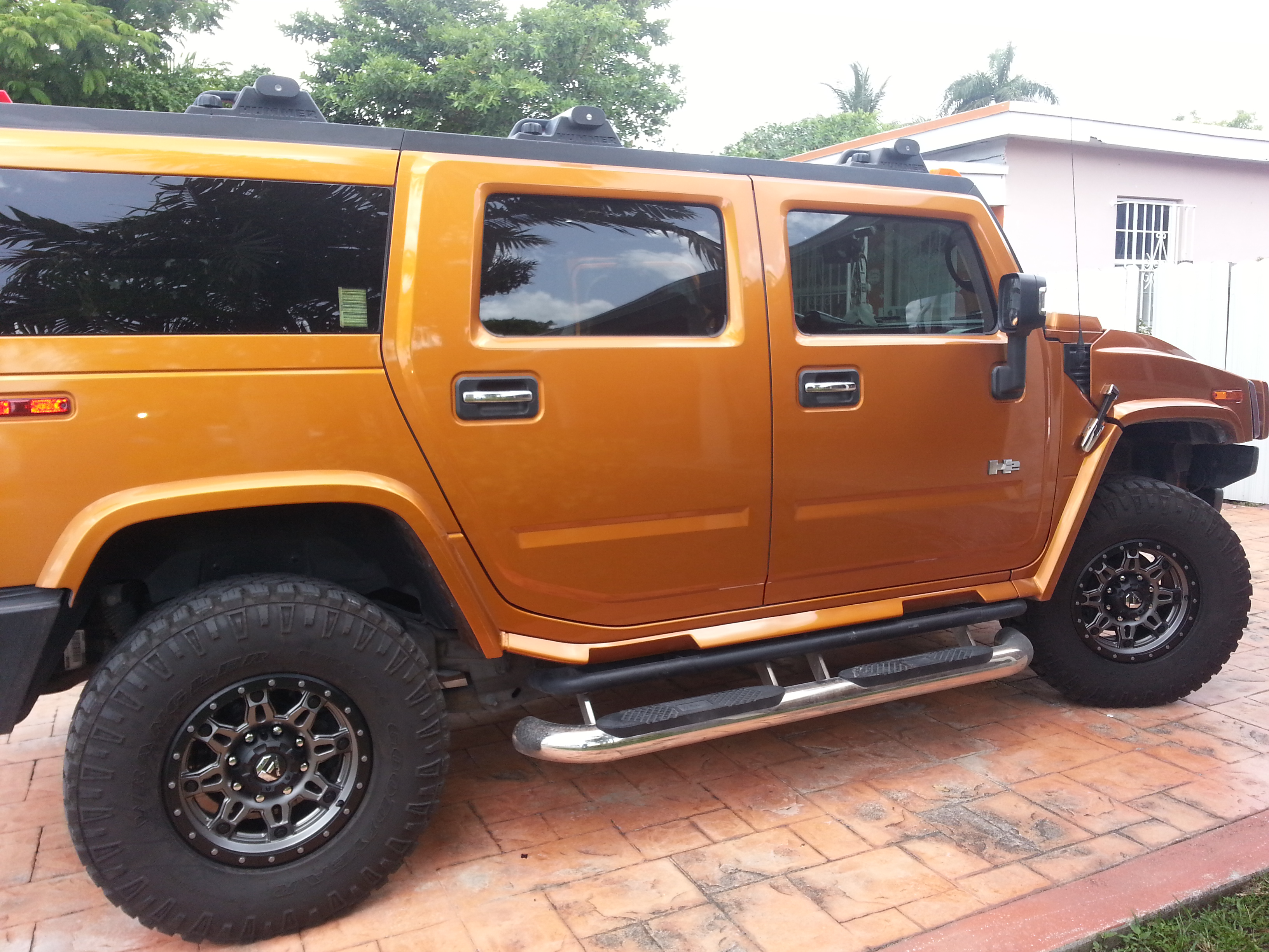

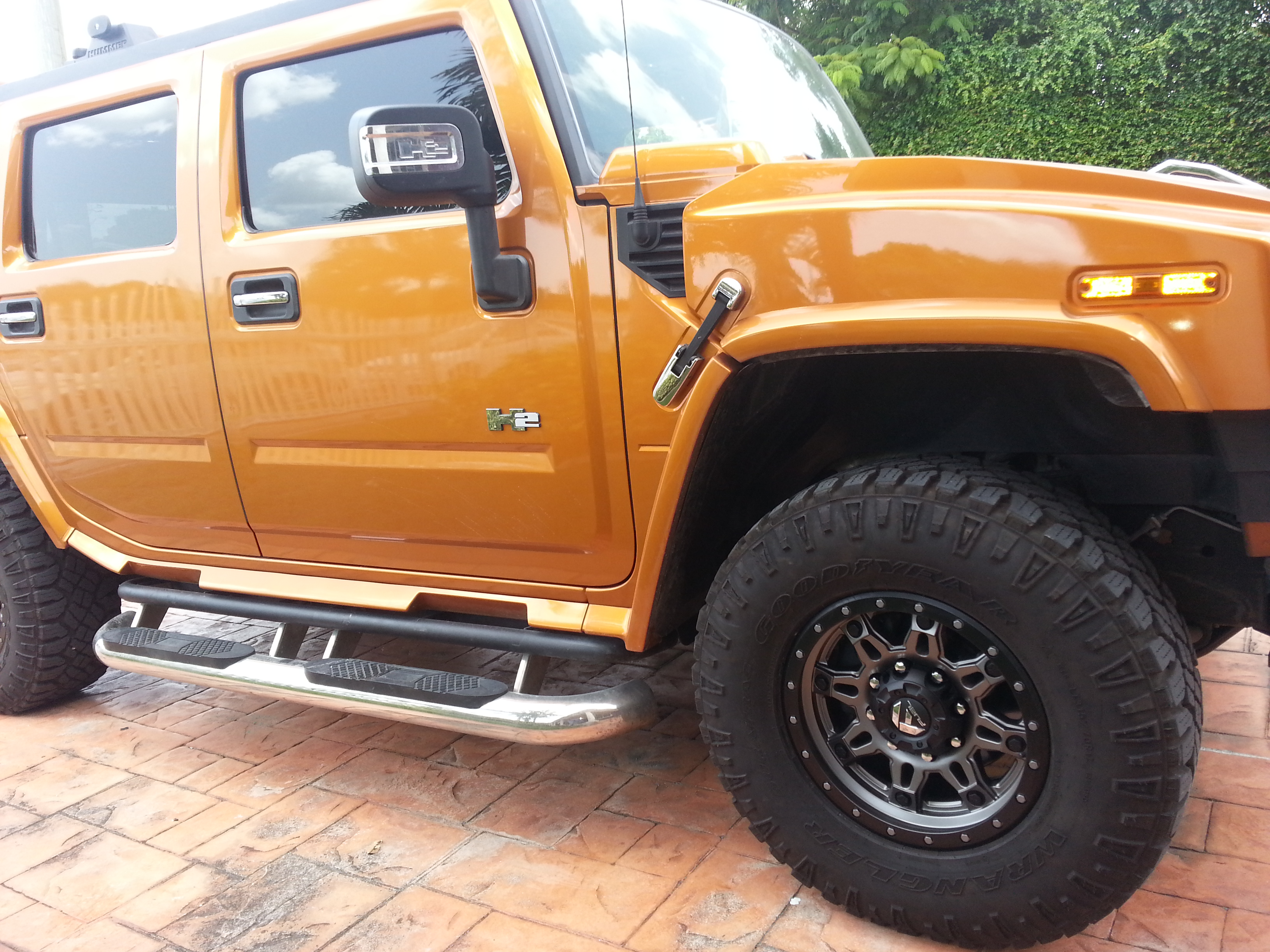

Finally the wait is over . The wheels came out very nice . The rubbing is minimal just on the sway bar at full turn
wheel specs
Fuel offroad
+20 offset
5.5 BS
17" x 9.5
8x6.5
The offset and BS align the wheels right where I want it with the flares
super happy with the look

Truck looks awesome.

Looks good!

Looks good.

looks good glad you got the offset backspace thing figured out, was reading your other thread on the subject after searching for some rims this week, ya its harder than I thought, my first choice..vender told me they will stick out past flares..no go, my second choice..discontinued...yep keeping the oems

Thanks .
Was stressful to figured the wheels algebra . The +20offset fit however I will recommend the +1 offset for better cleareance
I was looking to keep similar to the look of the OEM .
20" looks very nice bit due to the combo cost and all the problems which comes with changing wheel size I decide to go with 17"
so far the Fuel wheels looks very well made . Heavy however .
Hopefully also will help with cooling the brakes allowing more air trough
Im the type of person who always complain at first but this time I really like it out of the box

They look great. Love the grey. They look gunmetal, really, which is even better. I'm glad they worked out.
