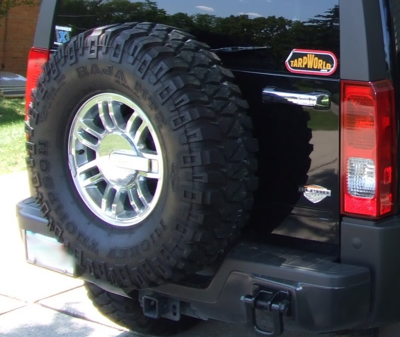

Originally Posted by kshummer
So let me get this straight.... I have leveled my H3 and have the stock 265's on it. I can simply put some hogs like these on my H3 and it will not rub much? How about power, do you lose alot? My H3 already gets crappy mileage so I'm not to worried about that
I'm assuming a 35" spare will fit as well?
Thanks!
315s (35s) will fit WITHOUT leveling and the rubbing on the sway bar will be less if you do not level it. Leveling is to even out the "stink bug" look and to gain a little more OffRoad clearance under the front diff. (SEARCH)
Yes, you will lose some power and mpg (SEARCH).
YES, a 315 will fit in the stock spare tire location (SEARCH).

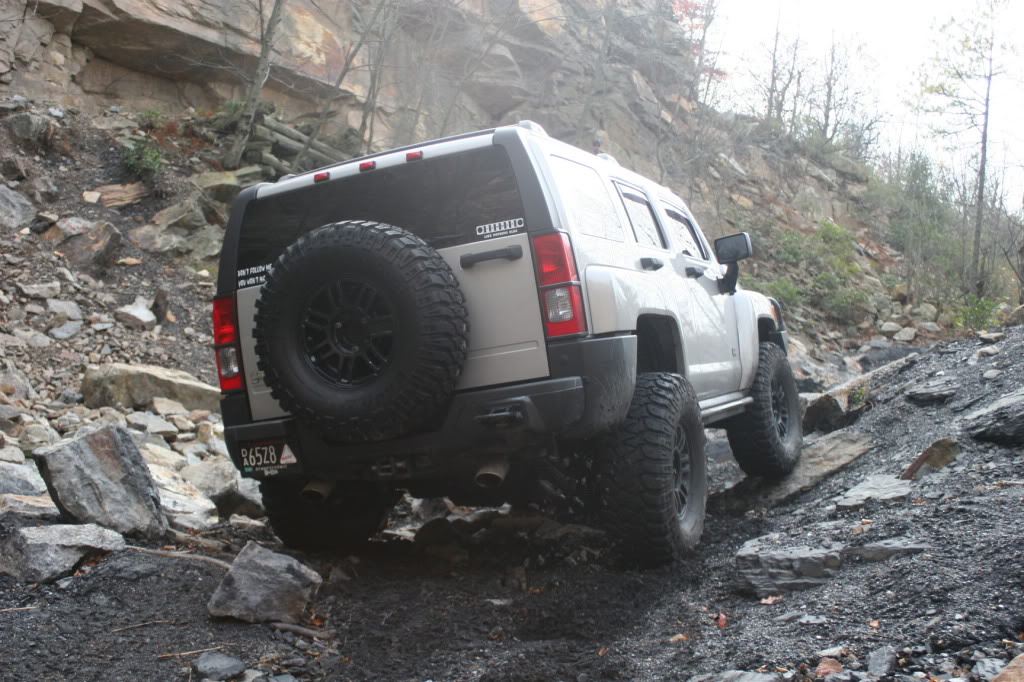

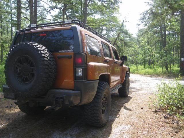

Old Dec 29, 2011 | 08:30 PM
Don't know it all about the H3s, but I do know how to search.
To prove what I am talking about:
Yep. It'll fit!

315/75R16 Goodyear Duratrac

315/75R16 BFG MT KM2

315/75R16 Mickey Thompson Baja MTZ
