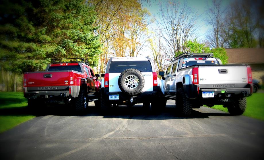

I took the Chrome Hummer ones off and bought these VTecs. I love them..They are 16's. I have 265/75/16 inch tires on them... I heard you have more options in 18's. But then you lose MPG and I think the truck is more wobbly then.. I was going to buy this other H3 but it had a 3 inch lift and bigger tires.. I did not like the feel.. I love the feel of mine, and the center of gravity is better... Here is a pic.. My spare is the same...
Very nice! I love the rims I have and thinking to just shave the calipers now after talking with a couple more wrenches...
