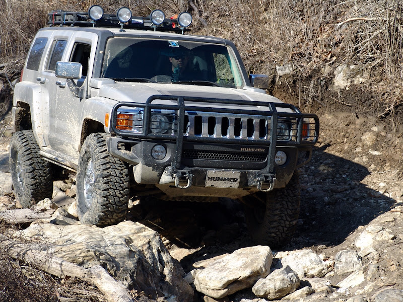

Part of what he said was somewhat accurate.... you should align it after cranking them....
BTW.... Here is a picture of his 35's that don't fit....

Here's another pic of 35"s not fitting! These are Goodyear MT/R 315/75/R16. That salesman is so[sm=bustedsign.gif]Welcome to the forum!
