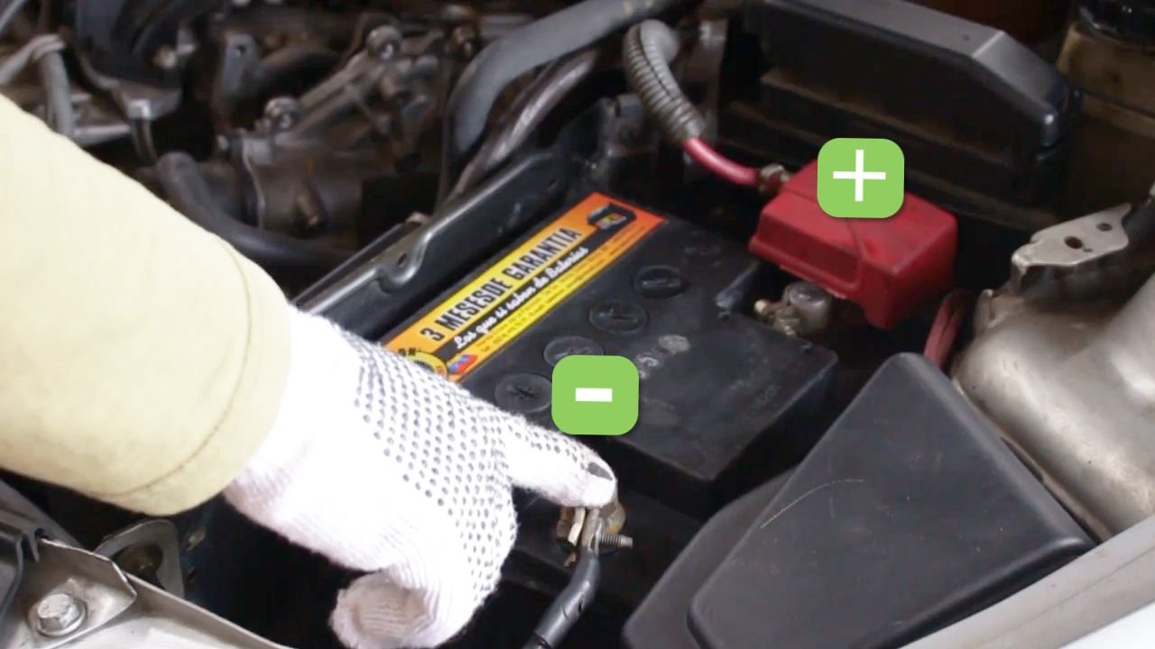

You missed the first step
Old Apr 2, 2019 | 01:36 PM
X2 on the battery terminals. OEM are POOP!
