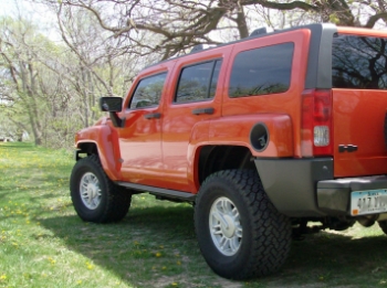

For your tire dilemma, check out 305's. The wider tread width that you are seeking without the added rolling diameter. They fill out the trackwidth of the H3 nicely. Perfect compromise imho.
As far as tire brand, I've run the Terra's before and had excellent results with them, but I'm currently running General Grabber aT2's in the 305 size, D rated. Like them better than the Terra's for winter driving and they are around the same price, maybe even a tad less expensive.
Here's the Grabbers in 305:
