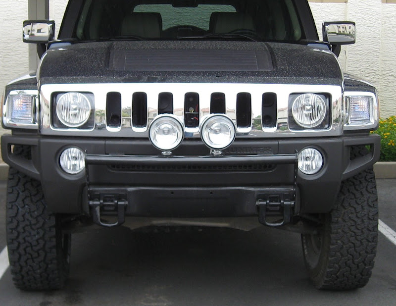

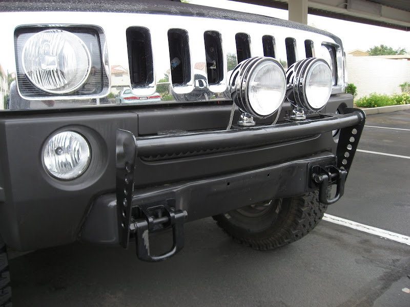

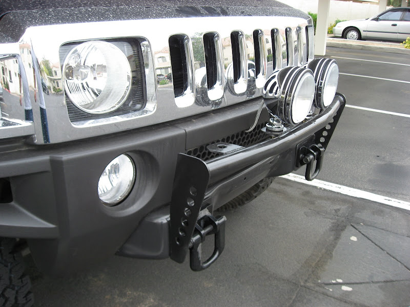

I had this light bar fabricated as I didn't want a full grill guard (nor the $ that one costs.) I'm going to end up with four lights on it. The two already mounted are 6" KC Daylighter driving lights; I'll add to KC fogs at some point. The four lights are designed to line up with the grill slots. The outside ones are just a bit inside the slots so the lights won't block the headlights.
I did my own wiring, using a Radio Shack relay and an Auto Zone switch in the dash blank by the 12V outlets.
The finish isn't great but it will do. I did it myself - rattle can of hammered black. No garage, limited space to set an area for spray painting. (Sorry about the dirt, Hummbob, it's raining today)

i would put one more bar across the top to protect those lights since it looks like you offroad it a bit
