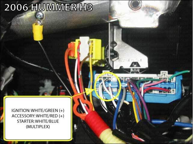

I'm installing some electronics (again) and need to know if there are any ignition-switched power wires other then the mirror and radio power leads somewhere under the dash where I don't have to take the dashboard apart to get to.
I know where the trailor one is but that is hot all the time. I need one to tap into for my GPS that is only hot when the ignition is on. This is a very low-power drawing plug so it doesn't need alot. I was powering my GPS charger and my radar detector all from the mirror power with no problems, but I don't want to take all that back apart to tap into it again. I'm trying to be a little more organized with the wiring.
If anybody knows of one and where it's located along with the color(s), let me know. Thanks!

I THINK the Pin 16 12V+ wire on the H3's OBDII port is only active during ignition. I'll test that. I'll probably use that if it's switched.
Old Feb 5, 2008 | 08:47 AM
HummerGuy's Avatar
Joined: Jul 2006
Posts: 6,692
Default RE: Need Switched Positive power lead location.
Where is that plug? Is it in the steering column or behind it? How much current can you draw without shorting it out?
Old Feb 5, 2008 | 09:13 AM
importkiller's Avatar
Joined: Apr 2006
Posts: 7,253
that should be under teh dash near the steering column....current shouldn't matter cause you should be using a relay in anything your adding anyway, just use that wire to trigger (energize) the relay and your good to go as big as you want.
