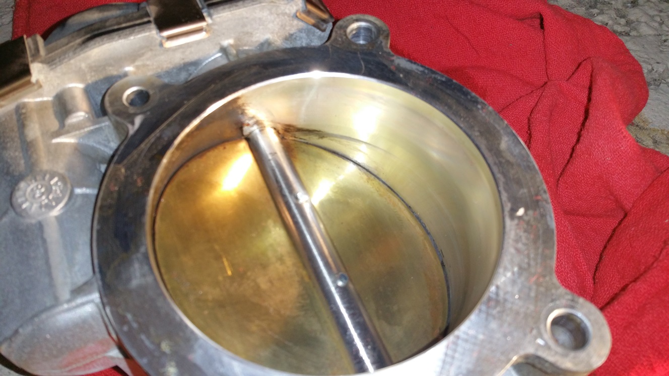

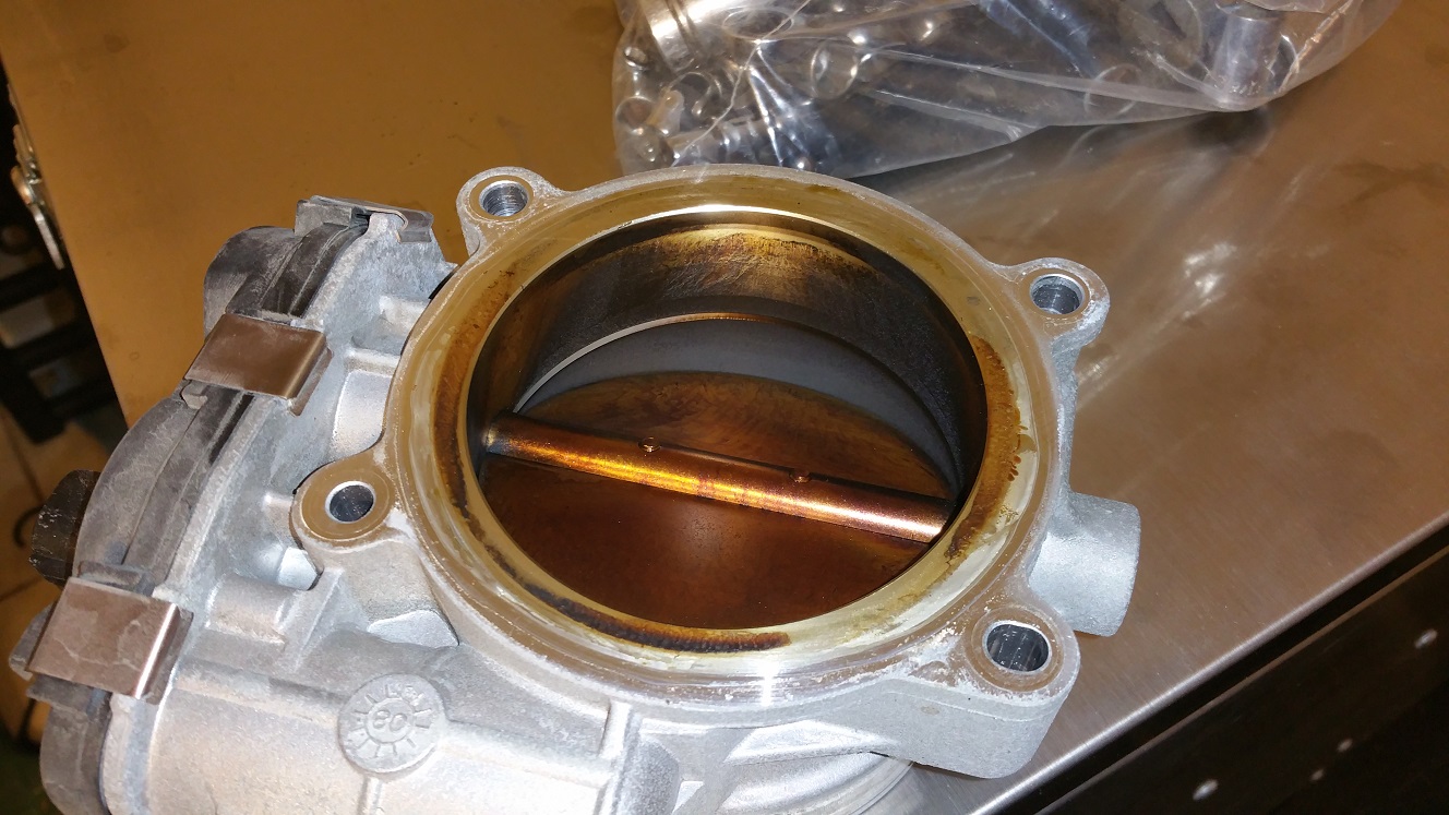

Not sure if this is correct, but I had someone tell me to check the throttle body b/c his vehicle shakes like mine when it's dirty. I've never heard of it, but figured I'd check it out. Mine's dirty...
Too late to do anything else. I'll put it back together tomorrow & see if that helps or not. At least it's clean.

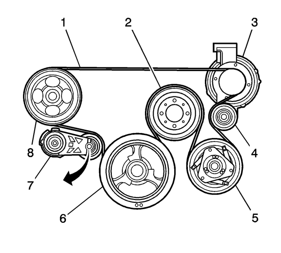

I might suggest that you remove the serpentine belt briefly and see what happens to the vibration. This will eliminate power steering and a/c. Don't drive it, just remove the belt and see what happens. There is a tension and idler pulley that if they were to go bad could cause this issue too.
I have added a generic pic to help explain:
