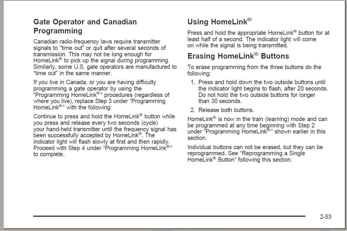

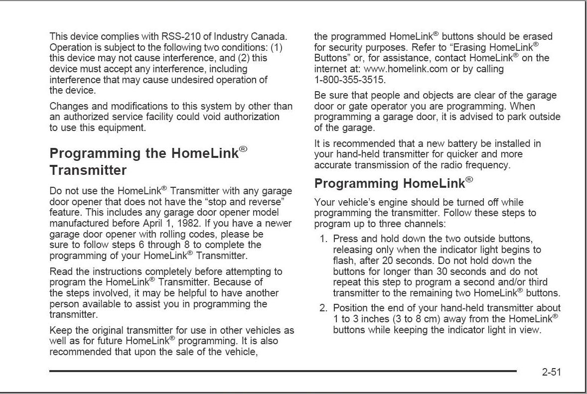

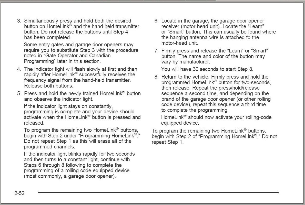

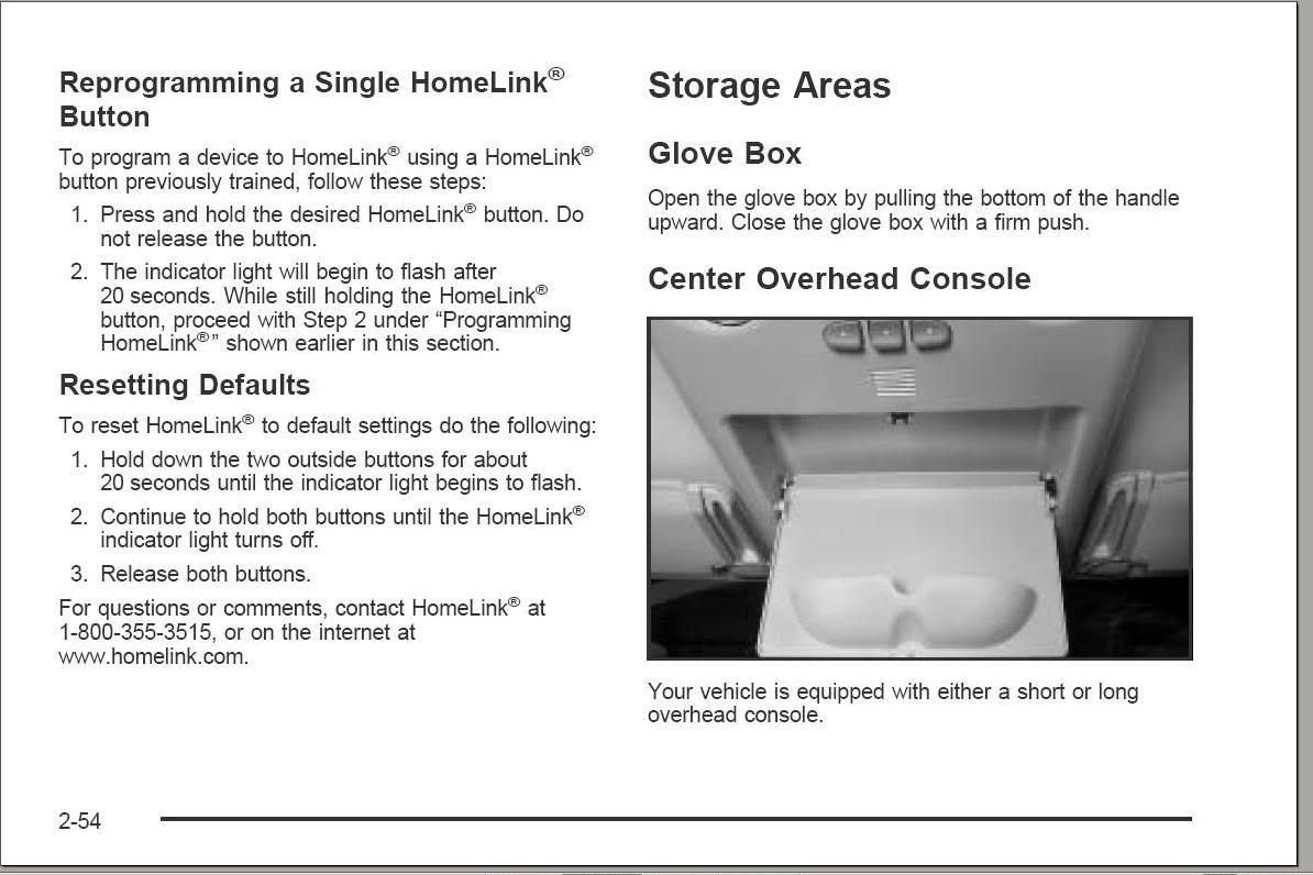

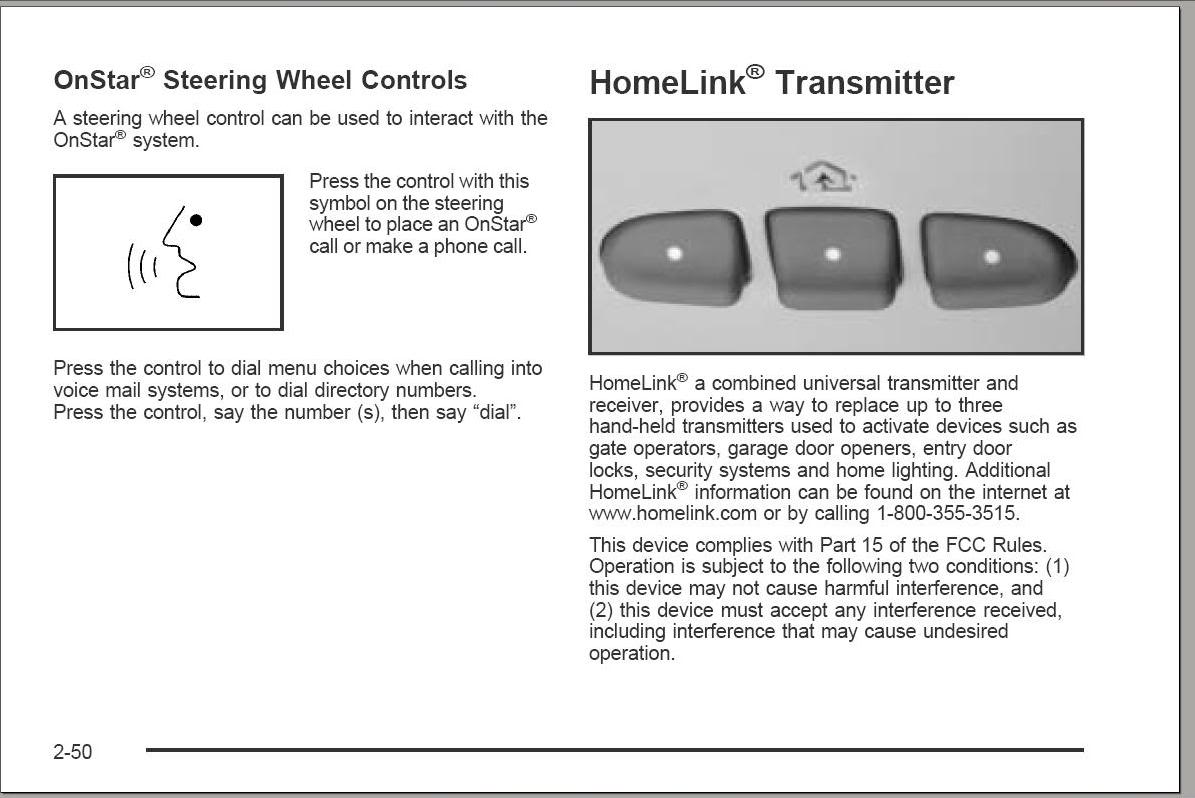

Hey can someone send me the instructions to program the garage door opener on my Hummer H2 2005?
