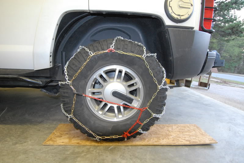

I chose two kinds of chains. Heavy duty for mud and light weight easy mounting high speed chains. Well 25-30mph. The high speed chains are used by law enforcement for ease of installing and removal and they are smaller size links with a cross pattern. The have a plastic sleeved cable that goes around the back so they do not need as much clearance and are less likely to strike the abs lines than chains with links would flailing around. They work great on ice and refrozen packed snow.
In these pictures I had a set of 285 MT/MTZ and did not have any problems.

I bought a pair of square link chains off tirechains.com and have had no rubbing issues at all with them. I even have 295/75R16 BFG KM2s. The thing I did note though is that chains and this tire work well together, the crossbars (parts that runs across the tire and give you grip) fall into the lugs of the tread pattern, allowing them not to stick out far past the original tire design. When the wheels are at full lock, if they didn't they would rub on the swaybar. I just did a lot of research before buying. I use mine on the front. With 265/75R16 you should have problems at all.
