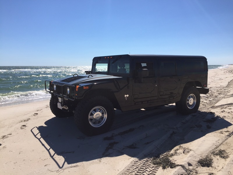

Floor height in the cargo area is the same as the center console. Same seat, just bolts in the back. Just as uncomfortable and harder to access. Unable to bend your legs and much less head room. Not many H1 were built. People bought them not realizing what was involved in keeping them on the road and some just bit the dust. If you purchase a H1, you are not worry about fuel efficiency. I have a GMC Yukon Xl Denali as my family truck, not much of a difference in MPG but HUGE difference in comfort. Two different animals. I have 4 children, my daughter drives the H3 and my 3 disable sons love the H1. Bought the middle seat so my short wife could sit on it for a short drive to the beach. My children are older and will not fit on that seat. If you have any questions send me a PM and I'll give you my Phone #.
