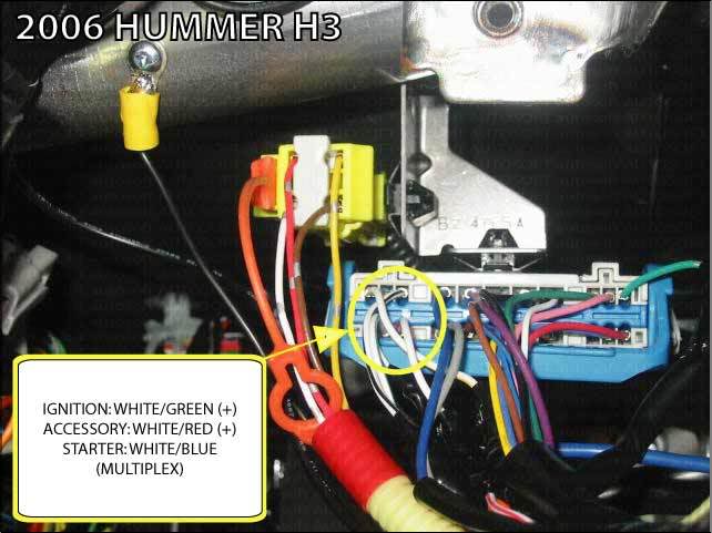

a search would help you out here...wish this site had one of those cool features
here is the wire you are looking for: use the acc. wire...that is switched with the ignition
