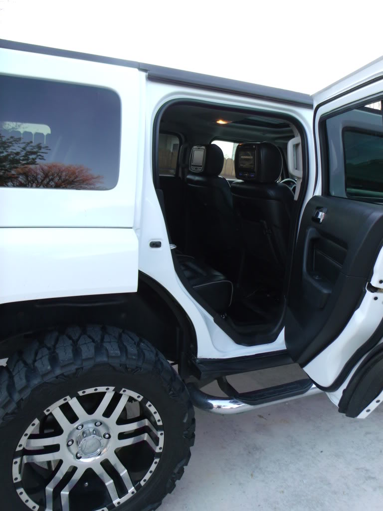

This is the adventure/lux package with 33x12.50r20 nitto mud grapplers with a matching spare and a few other add ons including a viper security system, all the Crome add ons, an aftermarket sound system, aftermarket exhaust system, led tail lights and 20" wheels with wide back spacing
I'm a first time Hummer owner and I'm curious to know how other owners like them. Previous vehicles include a 05 c6 vette, and an ss Silverado so I'm completely new to the off road vehical lifestyle but extremely intrigued.
I have a cousin who is a die hard jeep fan and owns a 1997 wrangler sahara.
All he does is talk **** on my hummers off road capabilities and we haven't even gone out yet.
I just bought this a couple days ago and plan on hitting the trails with my cousin this weekend. I hope I make him feel dumb for talking down on the h3.

However hitting the trails with 20 inchers is not such a great idea.
Try to find some 16s with some balloon tires. That would be a lot more trail friendly
Oh and remove the side steps when you go wheeling

Thanks for the advise guys. We didn't get to go out this weekend because a massive rockslide took out the local trail so next weekend were heading to the high woods. Lots of rocks and creek crossings. I will definitely take off the side steps and check into some more trail friendly tires and wheels. I'll take some a lot of pics when we go out and follow up. I don't plan on letting that jeep show me up!
One more question. He has his front sway bars disconnected and has 32" tires and a 4" lift. I noticed this makes him be able to negotiate some pretty large rocks without the body rolling. Will this stock h3 adventure come close to flexing as much as his jeep and if not is there any cheap way to make it. He went to the hardware store and jury rigged some simple disconnects. Does independent front suspension even have sway bars?

Be careful wheeling "like" a Jeep lol. They wheel alot different than we do with IFS. You have the adventure with a 4:1 transfer case, locker(s) and comes stock with 33's.
If your wheeling in rocks/boulders....I'd be alittle leary with those rims and nerfs man.
Old Apr 30, 2012 | 12:52 AM
If you dont' have UCP, STAY AWAY FROM ROCKS! Unless you have $3000 or more just laying around! Rock Sliders are also a good investment if you plan on wheeling rocks, stumps, etc. Plenty of great info on this site for you to get better aquainted with wheeling your new H3/H3T.
Like the others have stated.
-REMOVE the steps ASAP.
-Don't try to show off, low and slow (very little skinny pedal) is how to wheel and H3/H3T.
-No, your front end will not flex like a solid axle rig. But you have the advantage of a locker and 4:03 to 1 transfercase(Adventure Package). By the way you did not mention what year your H3 is?
- Just because your buddy says to do something, if you do not feel comfortable doing it ....DON'T!
-A lot of the Jeep owners I have wheeled with are "point-and-shoot"(heavy on the gas pedal) kind of guys. If you wheel like that in an IFS rig (doesn't matter what brand) you WILL damage your rig!
