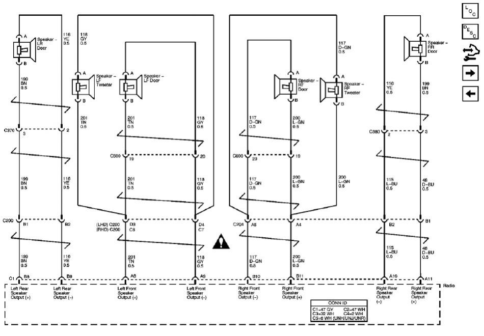

It doesn't look as easy as just going out and buying an amp and upgrading the speakers...but this might help. And swapping digital receivers between vehicles will activate the digital radio Theftlock® and "XM Theftlock®" will display. The top is for the Base, bottom Premium.
Old May 13, 2011 | 05:55 PM
drtom's Avatar
Banned
Posts: 2,652
anyone know why the monsoon shows 2 woofers?
actual pic of amp?,connectors?
oh btw note the cheap radio,tweeters tied directly in parallel with door spk!
