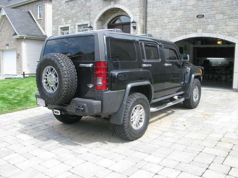

Worked on my mom's '08 Alpha. 2 days of fun!
Installed:
bfgoodrich ko2 285/75/16
front brush guard
rear tailight guards
roof cross bars
e&g fender flares with mud guards
weathertech window deflectors
odyssey 34-pc1500 battery with stinger terminals
k&n filter
front dome light
ddm tuning 55w 5000k hi/lo headlight and foglight
rear back-up sensors
replaced oil and filter with Mobil 1 full synthetic extended oil and filter
cleaned throttle body and maf sensor and reset idle with tech 2
replaced temperature control **** back light bulb
unclogged sunroof drains
restore windshield pillar plastic trim to black and install 3m double sided tape.
wheel alignment
Next mod would be to relocate the seat heater switch to the center console. That damn thing always turn ON when getting in and out the truck.
