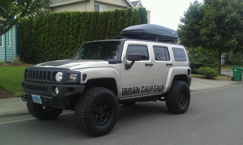

Hey guys, here is a question for ya. I know this subject as been hashed out several times on here but I am at a total loss. Here is my situation. I have an 07, I5, 60000 miles on it. CAI, magnaflow dual exhaust, PCM4less, K&N filter, and all the goodies. I run 315s and up until a few months ago was squeezing about 300-325 miles out of a tank of gas. Getting about 15-16 Mpg.. I was ok with that cause the truck has decent power for what it is..
At 55000 miles, I did all fluids including, trans, transfer, rear and front diffs, new AC Delco Factory plugs, new O2 sensors, new Optima Red top, cleaned the throttle body, cleaned the MAF with MAF cleaner. I recently noticed that temp was way to low and replaced the thermostat, which brought the needle back up to the half way point, after the new thermostat, the radiator cracked across the top, so that was replaced along with a new waterpump for good meausure. I have done everything I can think of. I am good mechanic and have a buddy of mine who works as a major shop here in town help me with all the work. I keep the rig in tip top shape, Have never had any issues with it.
I am beginning to have a love hate relationship with her, Every tank of gas I am loosing about 10 miles off the the odometer. At first I was getting about 300 out of tank, then dropped to about 290, then 280 and so on.. Now I am down to about 200 or less per tank.
I know the ol winter fuel facts, but I have a station that has 92 octane no ethynol added fuel, it does get better mileage using the fuel but its also a $1 more a gallon compared to super with the eth added.
I have had several shops look at her, drive her, I am getting no codes, no misfires, no power loss or any symptoms of anything wrong with other then its getting more and more expensive cause I am filling up all the time. Right now I am averaging about 10 miles to gallon on a good day. Every paid mechanic that has looked at and diagnosed her is stumpped!!!
There is no compression issues, no head gasket issues, no misfires, no Codes on the OBDII, nothing major going on.. So help, please!!! Anyone have an issue like this? I am thinking about starting over and doing another PCMtune but its spendy..
TAINTER, or fellas you have any insight? Cause if this does not get better I am gonna dump her and find something else to buy, I dont want to do that cause I love the truck, the way it drives and its perfect rig being a single father.
Attached Thumbnails Major Drop in Mileage, but no loss of power.. Totally stumped-259153_10150240428673805_688663804_7093935_6077674_o.jpg

Go stupid with it, knit pick...
1.) tire pressure them same on all 4 tires?
2.) fuel system gone over?
3.) intake system cleaned thoroughly including air filter?
4.) how is she idling? Excessive play in the needle while driving? i.e. bouncing from 1500 to 3000 rpms?
5.) that cargo box been on all along?
Anything else you can think of?

Have you always had a roof rack and carrier?

and ya, how long has that aerodrag box been on there? I just came from a ~1,500 mile trip to Az and back with a cargo box on top (xmas gifts). mileage took a big hit especially with the high winds I hit in the carlsbad area of texas/new mexico.
