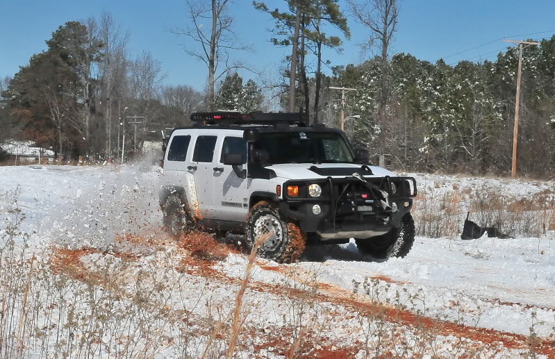

Driving in circles in fresh snow huh, sounds like fun.
I found that if you try to do a "dirt track" slide with stabiltrak on the dang thing will actually correct the slide. Tried it several times, it also briefly goes in limp mode so trying to cut the wheels and accelerate in the direction you want to go did not work.
I turned it off and managed a broadside slide and a 180 degree spin.
I was in 4 hi. Remote camera release, glad I missed the camera.

And Hunner you look like ya having way to much fun there! I miss living in Canada for that! lol
