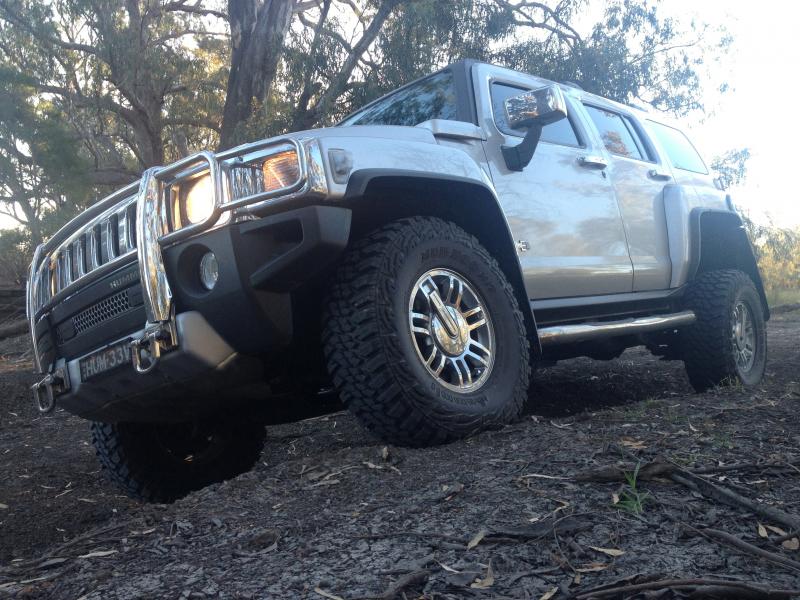

At this stage will not worry about shocks, but will keep this in mind once it's time to replace shocks, at this stage I will be making up and fitting some spacers to my factory ones next time I have a few days off.
Had a bit of a play today testing out the suspension travel, posted the below in my build thread but thought it would be relevant here, pictures were taken today!!
33" tyres with levelled (not quite) suspension, front set at 23" (from 21.5" standard) and rear suspension is at the standard 24", will soon be adding spacers for the front shocks, as they are still standard.
