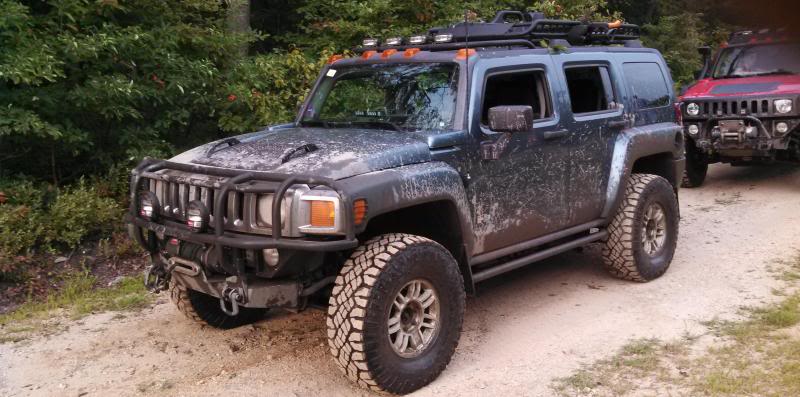

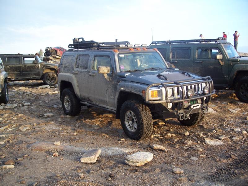

305/70/16 (33" diameter) is about 12" wide. 315/75/16 (35" diameter) is about 12-3/8" wide.
I have the Duratracs. In fact I'm on my second set.
I first went with the 33" tires but then realized that the 35's looked so much better. So I bought a set of 315/75/16's and replaced the 33's.
It would have been much cheaper to just go with the 315's from the start.
It may not look much different in the pictures but when out with my buddies and all of them running 315's, my truck looked like the runt of the litter.
So it was 315's for me and I added a 1" body lift too, just because.
With 33's
With 35's

Looks great Bunger! I just got the OEM racks and want to get a basket and lights on top like yours... Also just put a grill guard on and want to get a winch mount and winch. All comes with time and more money...I see you are from Connecticut... I'm from the Mid Hudson Valley. Your first pic looks like out west some place. As far as tires, I'm getting a price of $950 for (4) 315 BF Goodrich KO ATs installed by Mavis. The Duratracs are about $100 more. Trying to get them to throw in the alignment now for free...

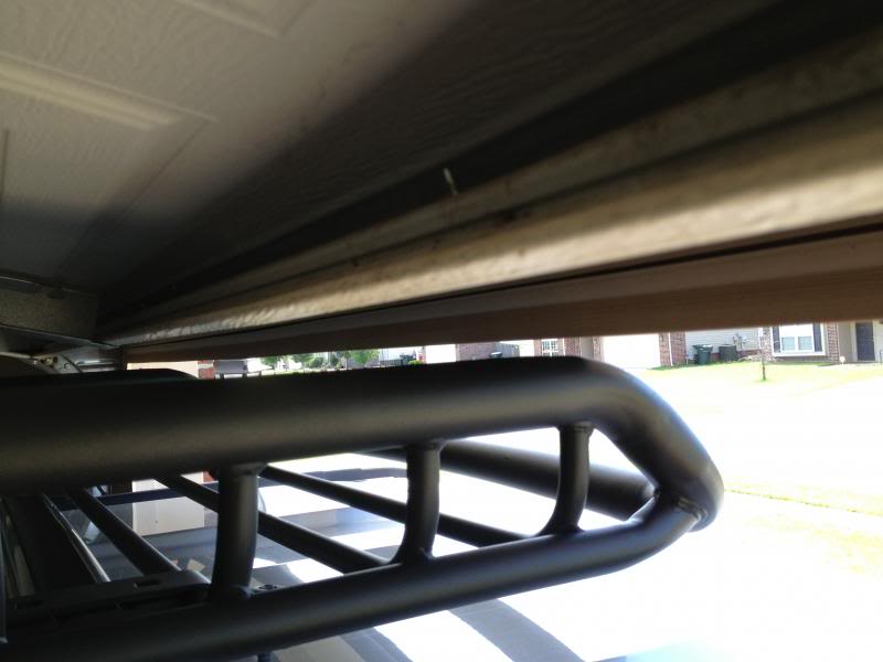

The Rola basket with extension is a popular rack on the H3. With 35's, shackles/leveled and the basket my Hummer clears the garage door by less than an inch. (I think my antenna is still 2" higher than the rack so that helps guage things in parking garages)

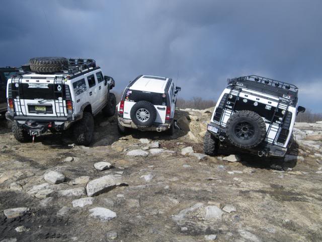

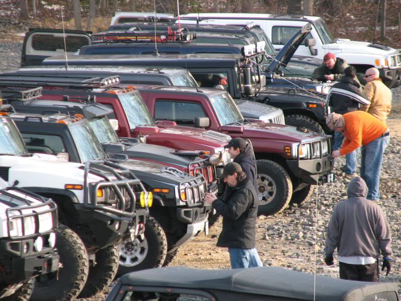

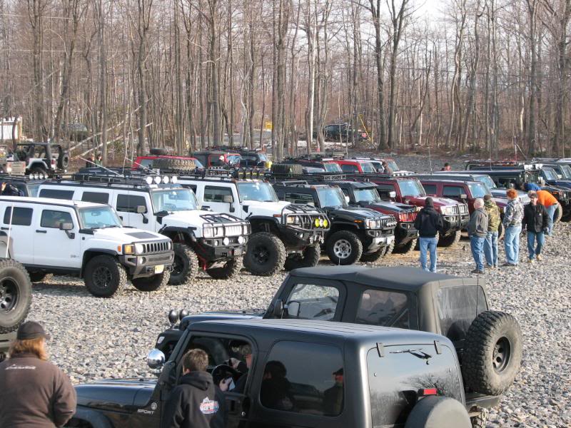

Both of my pictures were take at the same place - Rausch Creek Offroad Park in PA. A bunch of guys from the Northeast go every year, usually in April and again on the Labor Day weekend. April is the big run. One year we had over 30 Hummers show up.
