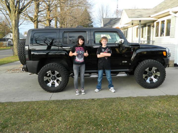

Cranked my T-bolts, installed new Bilstein shocks with extended bump stops (about 200 bucks) and got an alignment (45 bucks). Looks great and no problems.

Wow those prices are crazy... Mgoblue did it right... I didn't pay a shop anything to "level" my H3... Installed the bump stops and shocks myself, took it to the shop for the alignment (lifetime @ Firestone) for no charge too...
