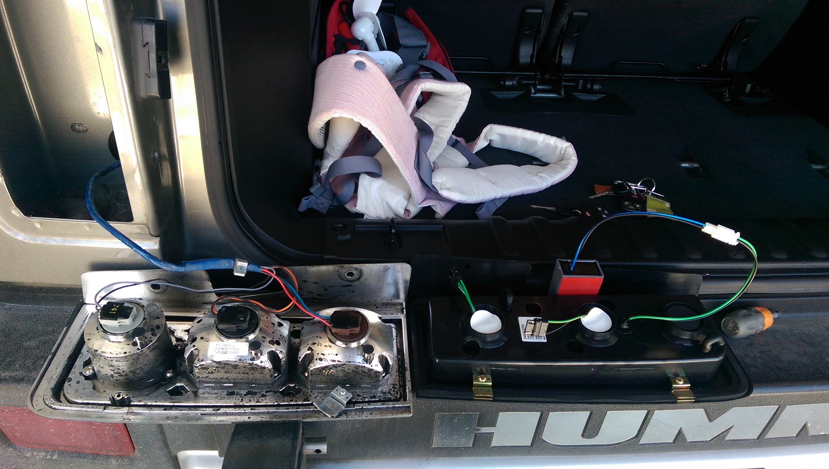

Sorry to tag onto this old post but I just purchased the LED aftemarkets for my 2008 h2 even after reading of needing some possible workarounds. When I took my old lights off which were an aftermarket also, it looks like the previous owner custom wired them too, so I need to cut all the wires and create new connectors etc, so I really need some wiring diagrams. Anyone have anything like that? I can't seem to find anything online. Or even just advice from others who've already done this install as I see quite a few H2's with these exact lights?
Light on left is one i'm removing.. One on right is new one with already wired connectors.
Thanks again,

Are you sure you cant remove those bulb holders, remove the bulb and push the black male plugs into the light socket on the new lights? That is how they are meant to install.

Yea, sorry I did end up just plugging into sockets and all worked well after reading that somewhere. Flash still alternate when brake and turn signal are on too.
